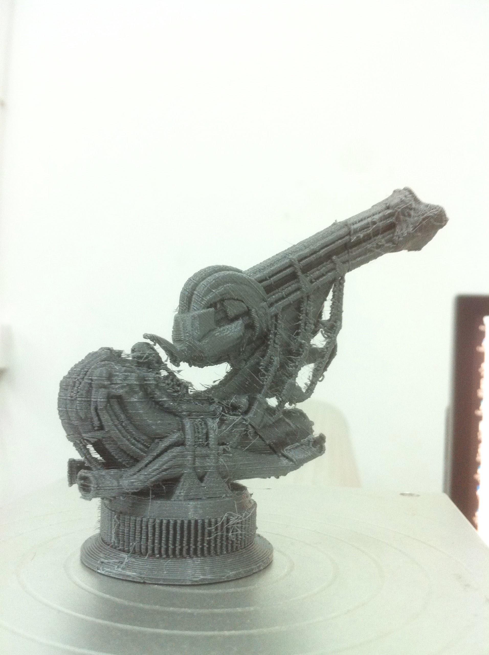

Printed this in seperate pcs together. Printed at 4cm height. Before assembly.
Want to know how to fix the hair issues. Which part of setting are the main cause? Thanks
It’s really difficult to determine the scale of this object – if it’s super small, occasionally there’s nothing you can do. When you’re only putting a small dot of filament and then immediately moving away, the pillar doesn’t have enough strength to stay steady and can cause this. Additionally temperature, and hot end design can all factor into this. Some hot ends have a larger melt zone than others, causing you to fight more with oozing which can make those hairs.
