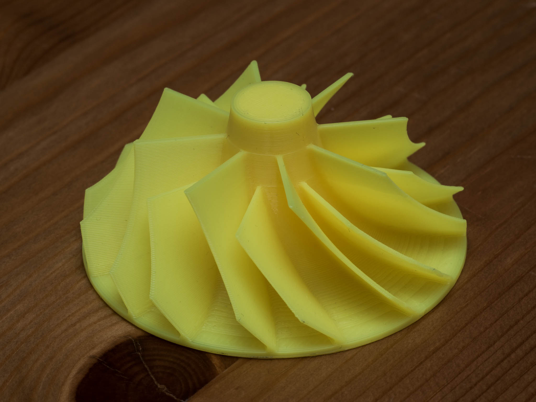

Printed this small blower a few days ago, this eustathios is awesome ! The grey filament is new, still need to tune some stuff. The fan is almost perfect.
@Maxime_Favre what do you use as hot end (E3D (normal or Volcano, nozzle size) and what do you use as cold end (Bondtech?)
Yes, E3D normal 0.4 and bondtech
@Maxime_Favre it’s a winning combination

Nice job! How well is the blower working? Is it louder than a non-printed version would be?
Beautiful print!
