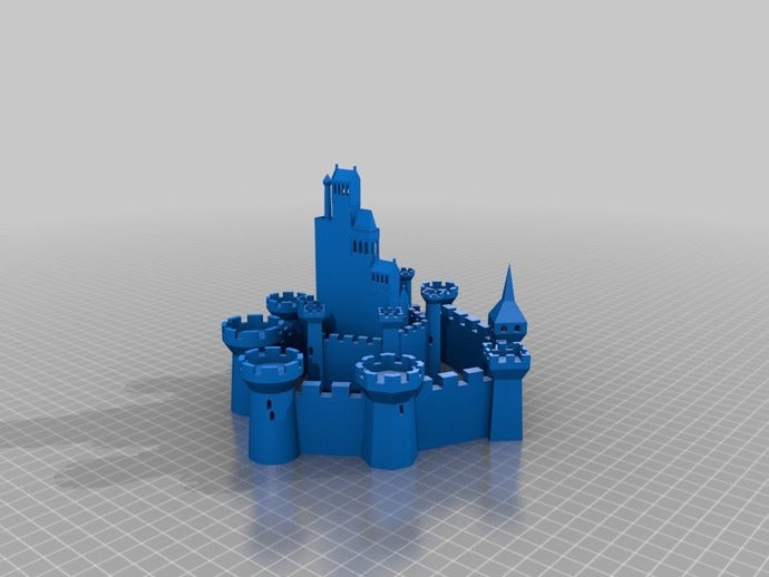

Printed with a 0.20 mm http://www.jerrill.com nozzle plus a little acetone vapor bath.
Nice!
Is it a model of a particular castle?
II don’t think so. I found the model here: http://www.thingiverse.com/thing:7013. I’m looking other things that would be fun to see in miniature if you know of any.
It looks a bit weird, the main house has large windows (so seventeenth or so century, post- defensive function) but the curtain wall is definitely a pre-cannon, 14th century or earlier style. Anachronistic 3D modeling! Also it’s fairly generic and symmetrical, that usually only happens when these things are first built and not after a few centuries of expansion, rebuilding, etc.

Cool. You may like this thing I’ve been working on…
In particular, castle.c which produces a rather elaborate procedurally generated castle model, or rather, it produces an openscad program which produces such a model. Still a bit of a work in progress though. And it is a bit of a CPU crusher, takes something like ~15-20 mins to render a castle on dual core 1.8GHz i7 – no idea how long to slice, but I am aiming for the models it produces to be 3d printable (no ridiculous overhangs, etc. – luckily the constraints of stone and mortar construction are not so different from those of 3d printing wrt overhangs and so on) but I have not tried printing one yet.
Edit: uploaded an instance of this program’s output to thingiverse:
Very cool castle! I noticed the one on thingiverse is more elaborate than the one rendered by the code generated by the github project. I’m assuming there are some configurable options somewhere, but I didn’t see any in the castle.c file. @Stephen_Cameron
It’s random, or rather, stochastic. Each time you run it it produces a different model. Sometimes it makes something really simple and dumb, sometimes it goes nuts.
If you want repeatability, you can replace the line in castle.c that says “srand(tv.tv_usec);” to “srand(1234);”
basically, set the random seed to a constant, and it will always produce the same model. Put in different constants to get different models.
