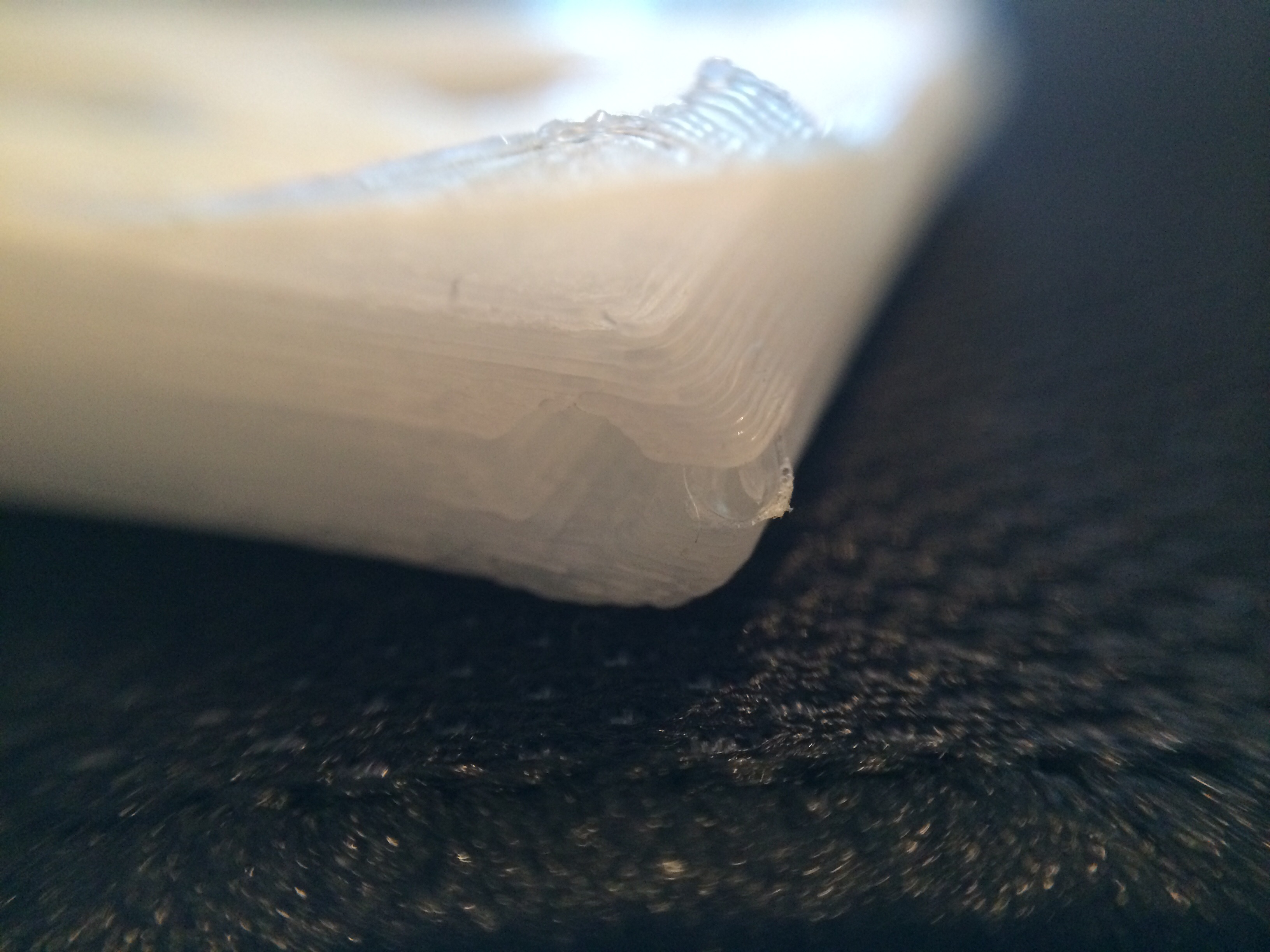

Printed with taulman 618, but not strong, any idea what going on ?
Is this the wishbones? Because it is recommended to print them vertically so the layers are orient 90 degrees to this. That way they will not delaminate, which is what it looks like happened. It is so tempting to print these parts flat because it is much easier to print and faster, but not as strong.
Yes It is , I’m going to try , I had some problems related to adhesion… I’ve tryed with heated bed, without heated … I have some dificults to buy garolite here in Brasil, and I hear some people saying that this is the best surface for taulman…
