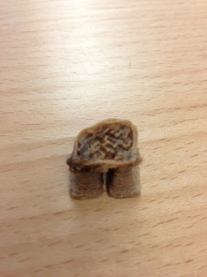

I printed Thing 4203 (http://www.thingiverse.com/thing:4203) on blue painter’s tape with the bed at 50C and the hot end at 190C. While my y-axis still needs a little adjustment, the print turned out decently well on the outside. The fill, on the other hand, didn’t work well at all. I couldn’t tell if it was because there was no material extruding (which would have been weird considering the walls came out find) or if it was because the wood just can’t bridge well to fix holes further down the infill – but I have a hole in the top of the print. The top didn’t come out well. I think that was heat-related as the small layers didn’t have enough cooldown time, and I don’t have a fan.
