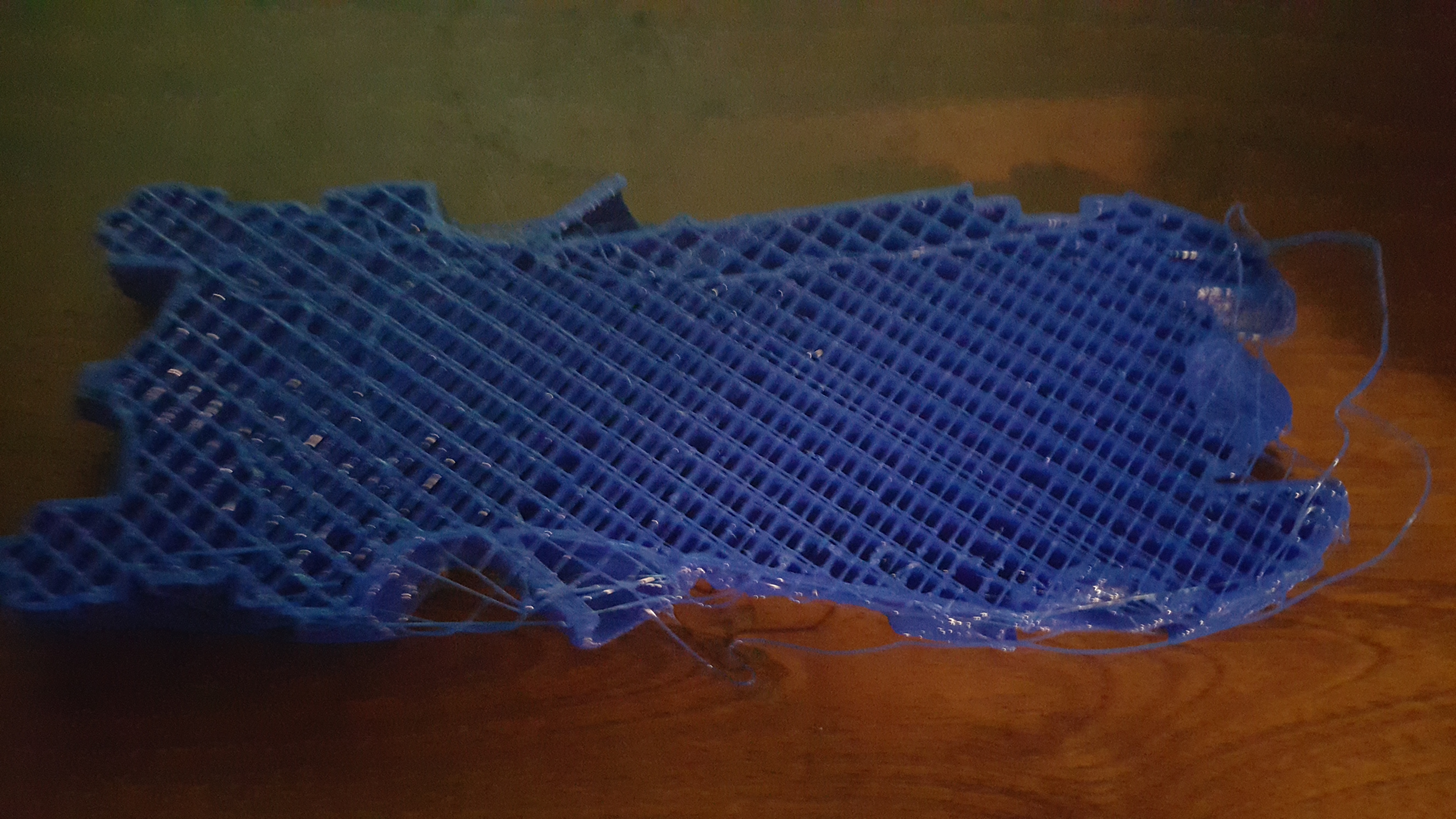

Printing a batmobile then this happened after 1hr in. Using PLA at 210 degrees.
Printing a batmobile then this happened after 1hr in. Using PLA at 210 degrees. Had to change the position in Repetier because the horizontal print attempt was off the bed. Help is appreciated
It looks like you had layer shifts in X and Y. Check the pulleys to make sure they can’t slip on the shafts, check the belts to make sure they’re not loose, and next time feel the motors periodically to see if they’re problematically hot.
I encounter slips on melzi boards, if the belt is tight, your stepper isn’t getting enough juice, try adjust the trimpot on the board
