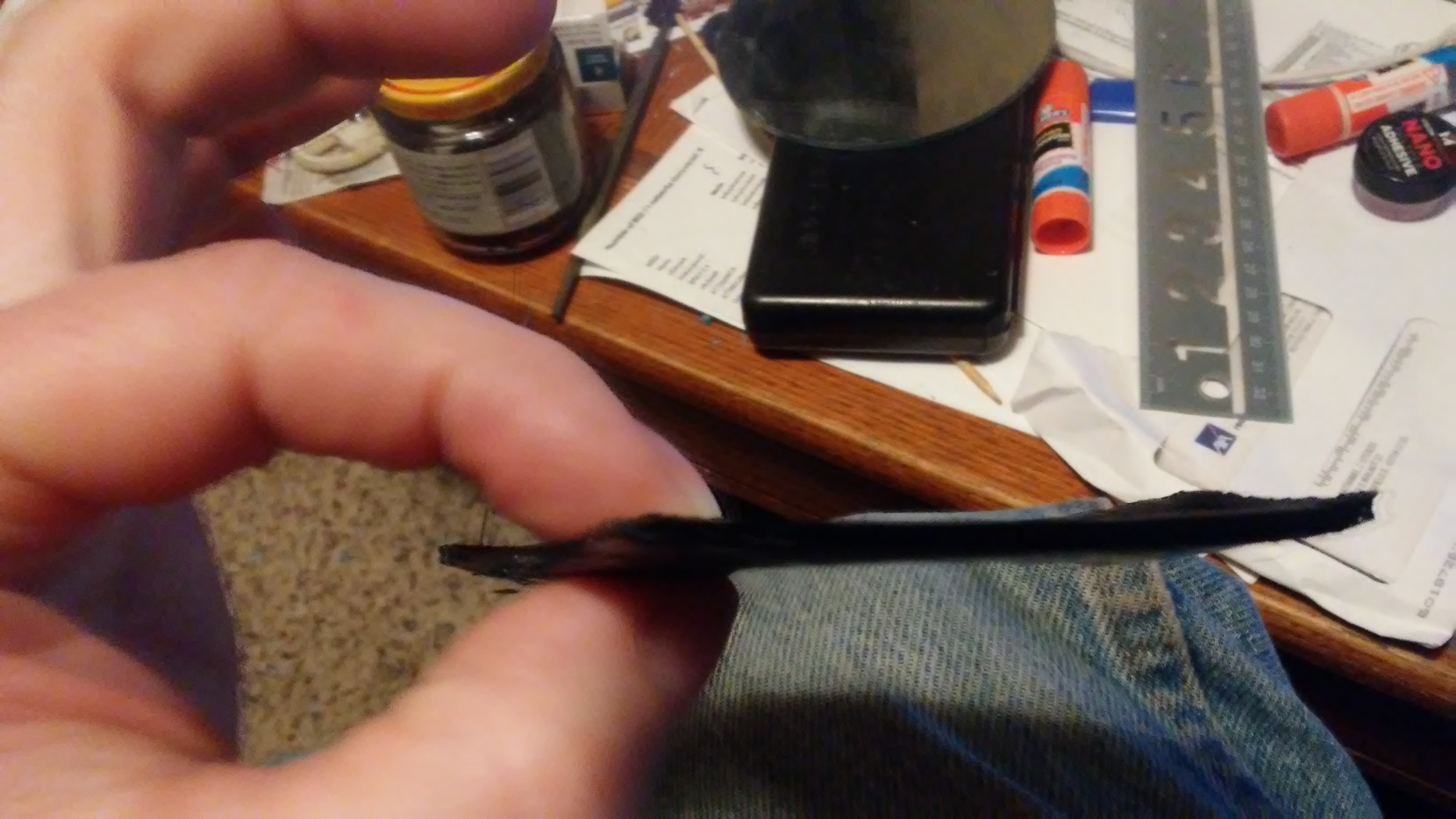

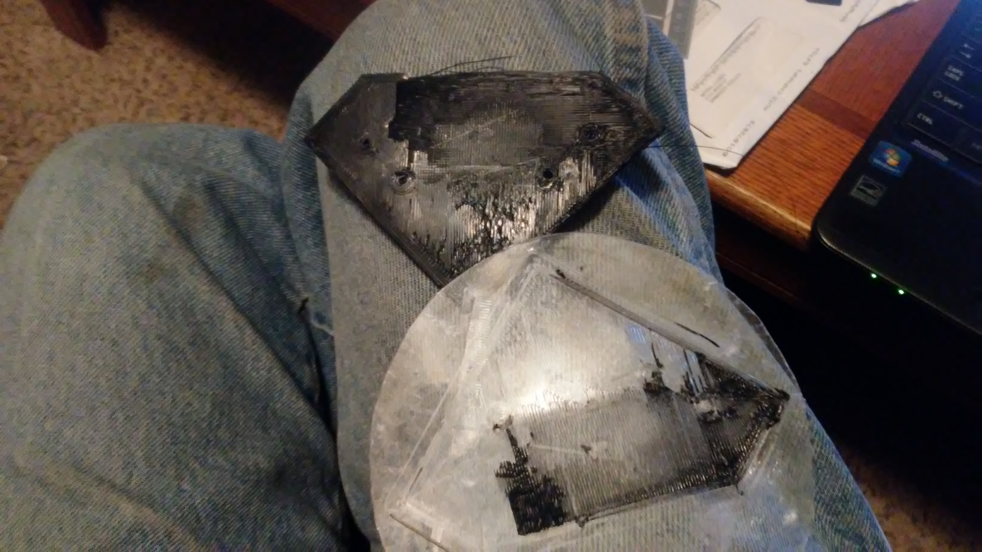

Now attempting a print on acrylic clipped to the heated bed set to 60C. No glass in between. It for whatever reason did not have the bed up to temperature. The first couple of layers are crap. That would not had mattered if I printed a raft first. I will let this continue printing for a while anyways. Part of the reason for it looking like crap is that it had trouble extruding filament for a little bit. The initial 3mm are now done, so it is printing with the part/hotend-fin cooling fan turned on. It seems to be putting down better layers now though. It looks like the part will be kind of ugly on the bottom but I think I will let it continue anyways and share a picture when it is done.

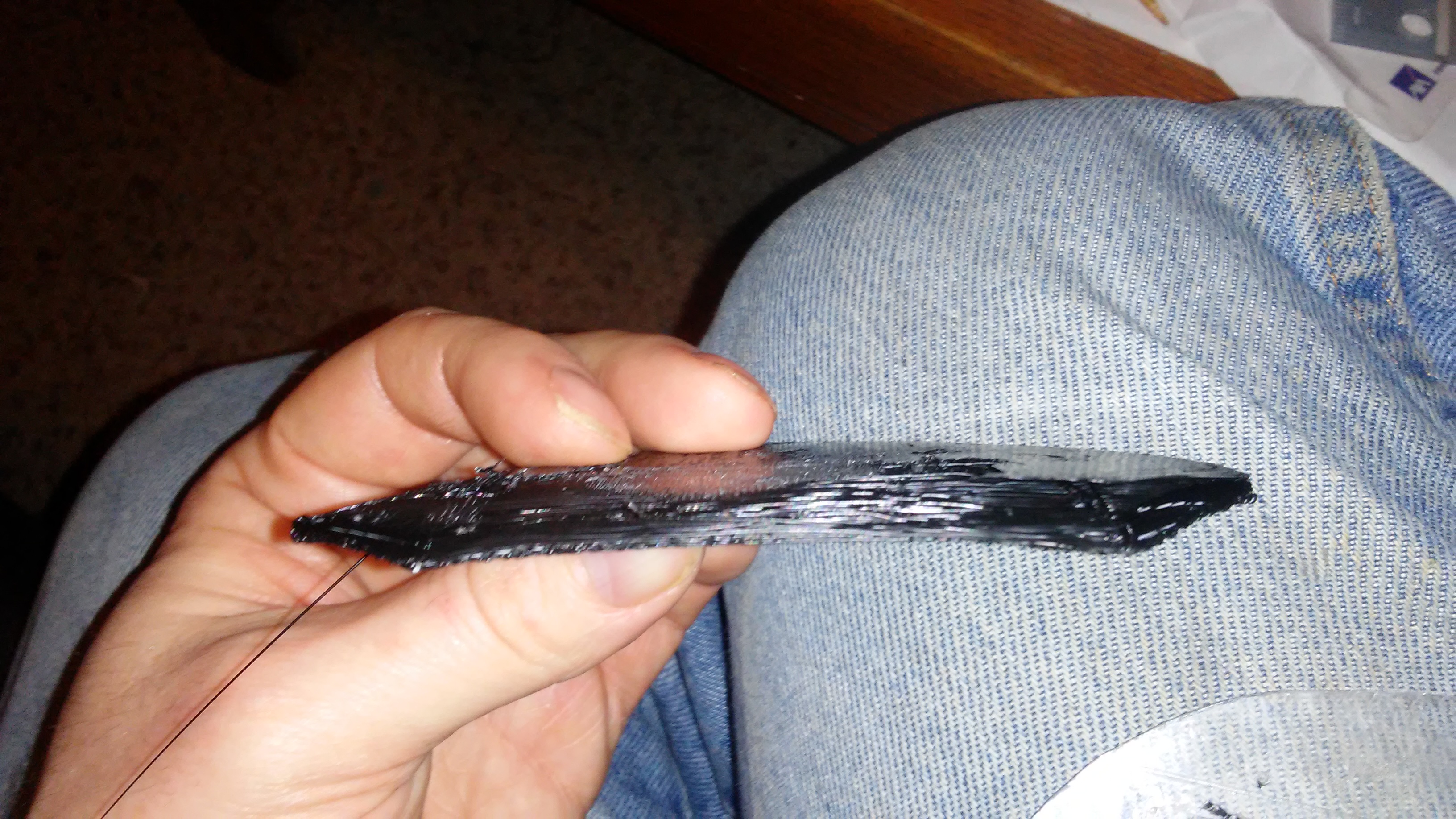

Well, it is not warping off the bed any worse than it did on the previous printer with the bed set at 100C. That is still not optimal, but this is an ABS that is something like 4 or more years old. Formulas change. It probably only cost me $15. I have always been the cheapskate. It is black filament too and that color tends to be a pain to print for ABS.
I changed my mind. This is too painful to watch. The curling on the one side is so much. Even if it was no worse than I would sometimes get on the 100C bed, this part is already enough of a failure. Aborting.
Some of it was so well embedded into the acrylic that it was left behind on the acrylic after separating the print from it. I think the failure can be blamed on the temporary nozzle jam and the bad bed adhesion which can be blamed on the mini binder clips interfering with the bed leveling.
