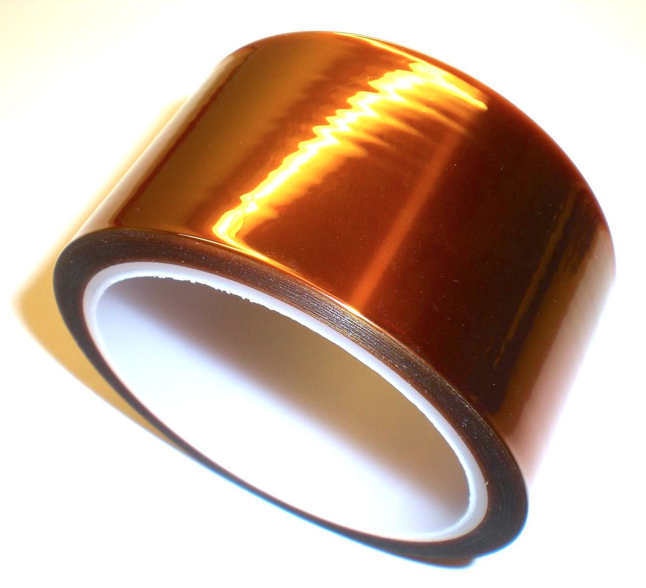

After studing some articles over the internet i make next conlusions:
  1. When printing, the heated bad must be at 70C (not 110C as usual)
  2. You must remove the printed shape after full cooling of the bed (or you can tear away a part of the kapton layer)
    3.Kapton layers must be fitted to bed without overlaping & air bubbles
  3. No need to remove the kapton layer after printing (in some cases it still work about month of printing)
  4. the printed shapes has a more tendency to curve (because the bigger difference of temperature)
I will be very gratfull if you confirm or refute my conclusions. Also it will be great if you add some moments which i missed.

@Whosa_whatsis I don’t know about 70C, but I’ve measured mine with an external thermocouple, as I do not have a controllable bed, and found mine was at 80C. Admittedly I can’t remember if I used a surface contact thermocouple or just a bare twisted pair. (Maybe I’ll remeasure some time.) My ABS parts are frequently difficult to remove from Kapton. The adhesion also seems to depend on the layer thickness and obviously whether or not I had the nozzle close enough to begin with.
I also sand my Kapton with 220 grit sandpaper and then wipe clean with IPA or acetone.

Also with kapton I set my nozzle height even lower than usual so the first layers are pushed down onto the kapton firmly. I compensate in the model with a small 0.5mm chamfer which fills up.
Also I remove without cooling the bed, infact I think waiting for cooling makes removing it cleanly difficult.
