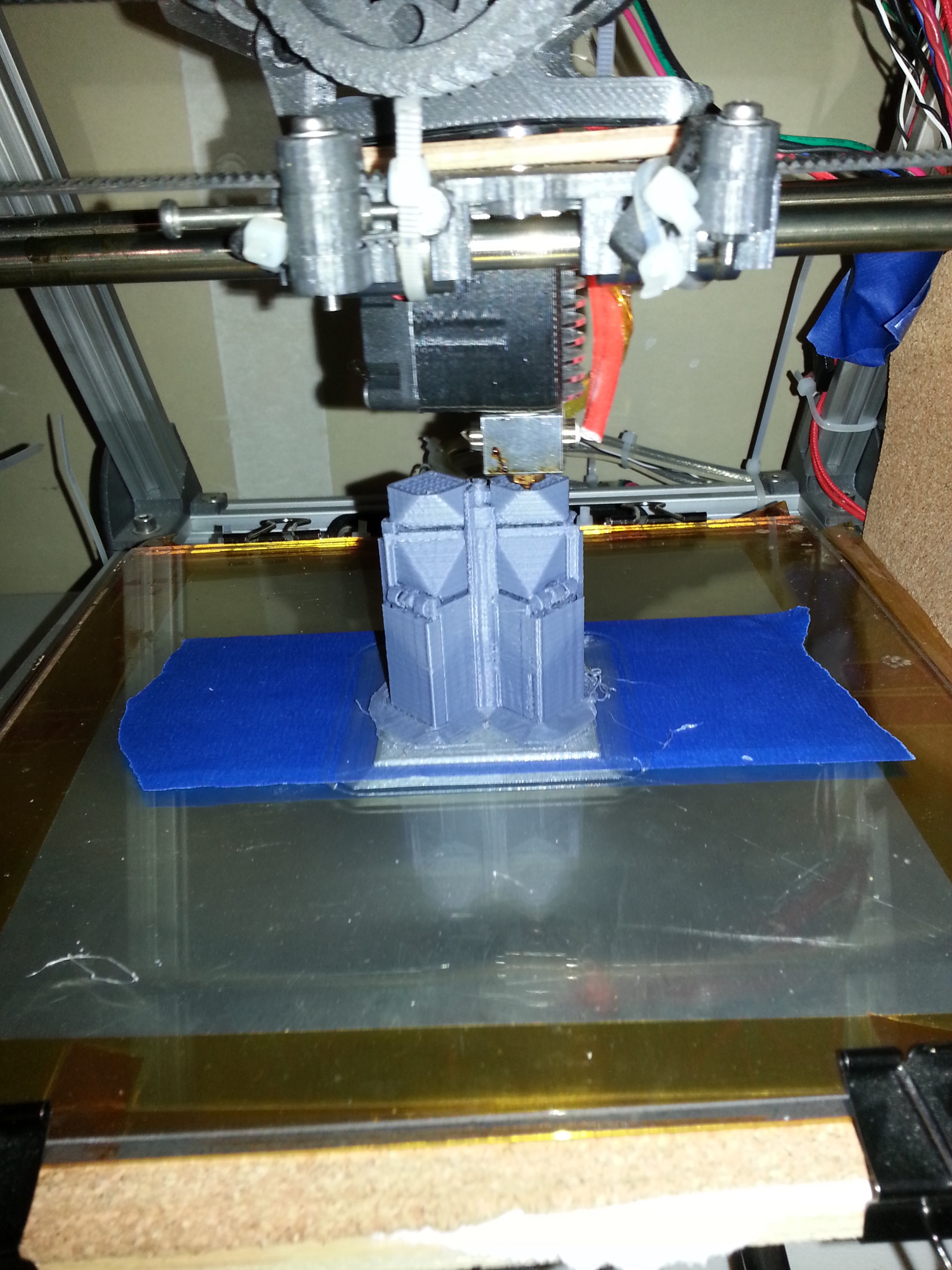

Printing ABS on PLA on blue painter's tape at 50C.
Printing ABS on PLA on blue painter’s tape at 50C. I can hardly believe how well it works!
I normally just print PLA, since I have trouble getting ABS to adhere to the bed without warping. (No print enclosure yet) This is the biggest ABS object I’ve ever been able to print. Better yet, it popped right off the 1mm PLA build plate without damage.
