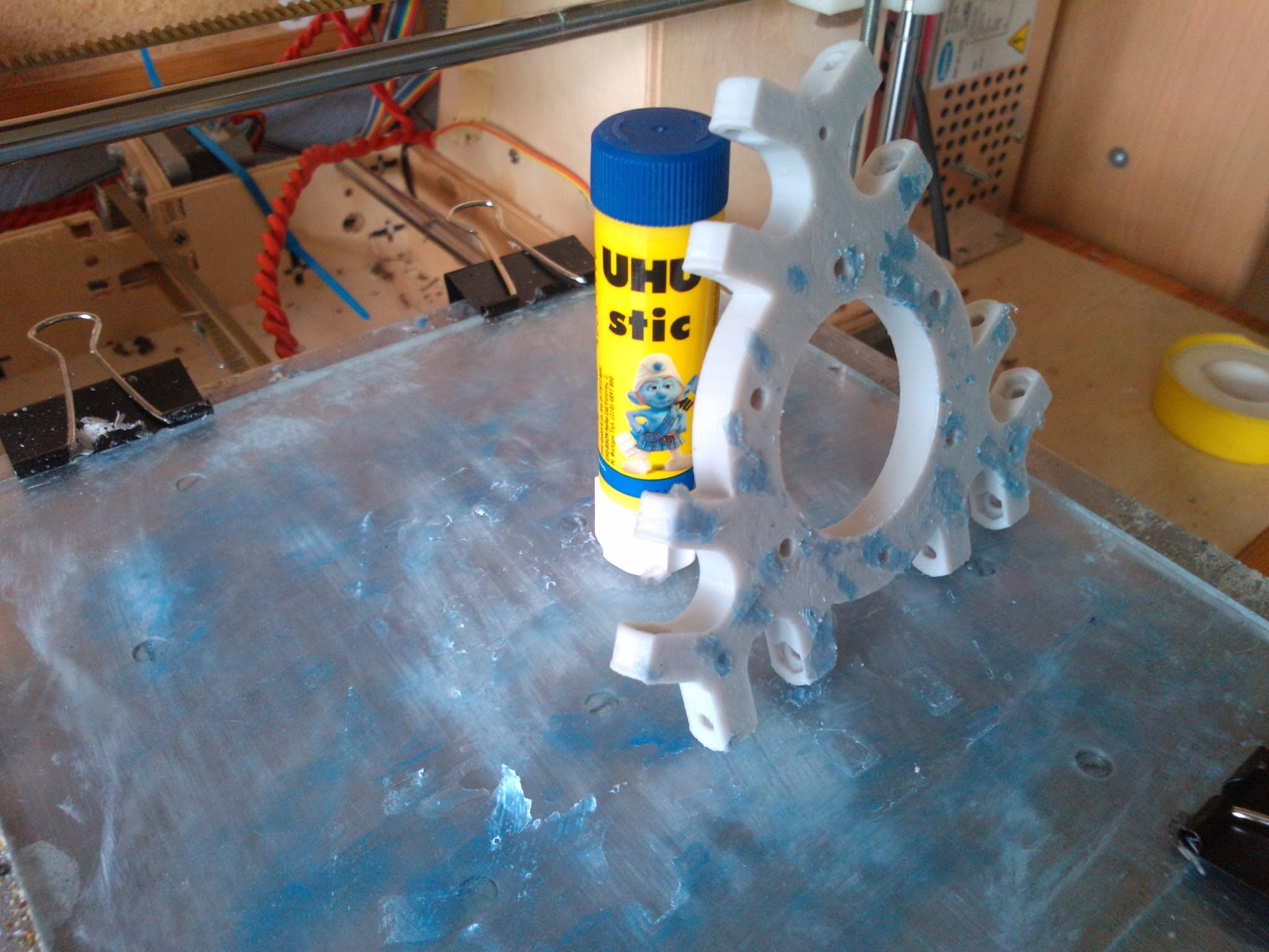

Printing at glass covered with uhu stic paper glue.
Printing at glass covered with uhu stic paper glue. Temperature at table is 90st C and everything stays there until print is finished;) . Here is picture after printing, some glue stays at print but it is caused by putting glue at hot plate. If you put glue at cold table and wait there will be no signs of it.

Yes uhu is water solvable and easy to remove. This print is ABS, for PLA it works too. I really like this simple solution.

Well, this solution is also alternative to Elmers school glue. I don’t know if elmer’s products are avaible in Poland. Picture shows what happen, when you are putting glue stick on already hot hotbed
