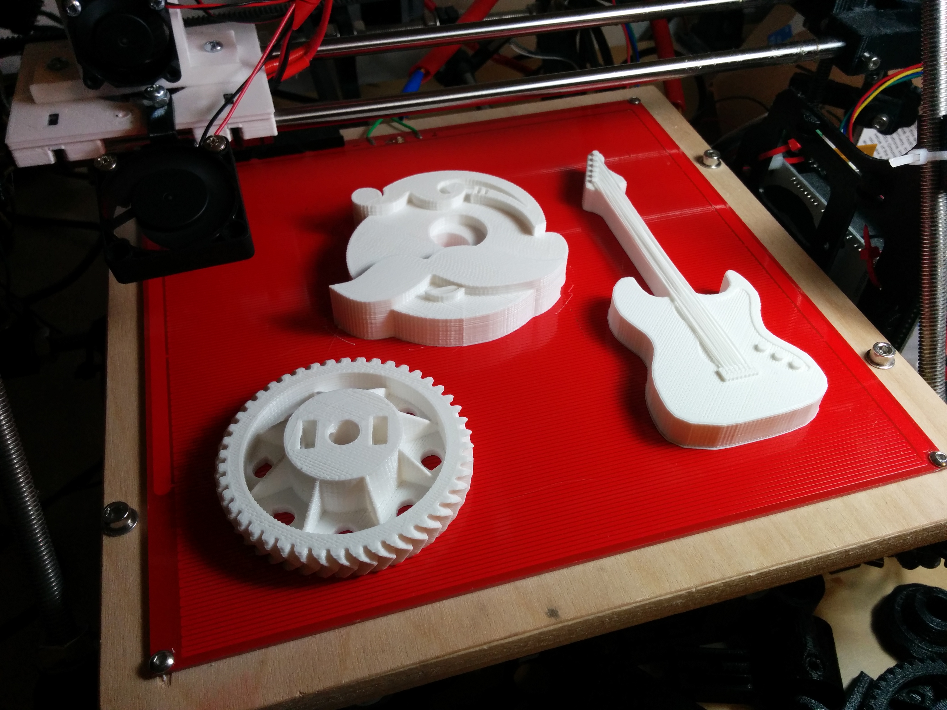

Printing for multiple projects at once really does lead to some random assortments on
Printing for multiple projects at once really does lead to some random assortments on my build plate…
Nice, your builds are very clean. What are your run specs?
Thank you! PLA (the $20 stuff from Microcenter has gotten much better) at 220C. These were done at only .2mm layer height, just for speeds sake. E3D v6 1.75mm universal hot end with a .4mm nozzle in a Bowden configuration. Sliced in Cura which I used to hate but have gotten excellent results with the latest release.
This plate finished in about 3.5 hours, overall speed in Cura was at 50mm/s.
What printer is this?
+Step Cia a Reprap Prusa i2. You won’t see many using them much these days, but they’re able to give good results if you are willing to tweak them CONSTANTLY. Later printer designs like the ultimaker variants and the i3s are superior in many ways, but this was my first printer build.
