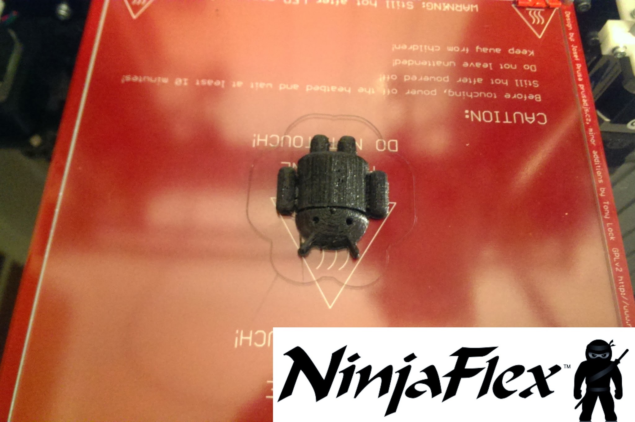

After lots of trial and error I’m starting to get some pretty good results with NinjaFlex (even on complex shapes like the Android below) and I thought I’d share my settings to help others get a starting point because for some reason there seems to be a lot of strange advice out there which didn’t match my experiences at all.

One of the pieces of advice I saw quite often was “don’t use retraction with NinjaFlex” accompanied by photos of really stringy prints from people that didn’t use retraction. I can only think this is aimed at people with Bowden style extruders or something like that(?) because I cranked up the retraction both in distance and speed on my Mendel and got far better results. One of the issues is the squidginess of the NinjaFlex accompanied by the slightly higher heat means it tends to dribble. At the moment I’m running a 3mm retract (prime/suck) at 40mm/s and as you can see from the photo its achieving quite good results. I need to experiment and find out what the sensible limits on my Mendel are as faster and further seems to be the way to go.
