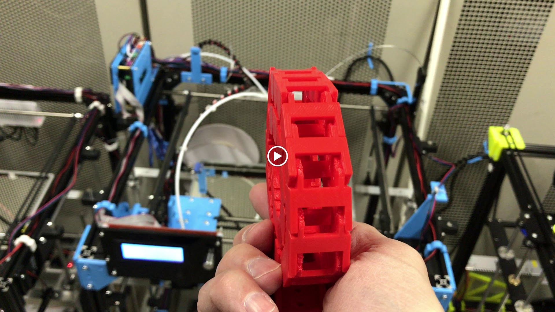

Printing open chain at 85% flow works the best.
PLA, 200c, 60c bed, 0.12mm layer, 1.2mm wall/shell, 100% cooling, Retraction on, 85% Flow rate
Those numbers vary from printer to printer and it also depends on which PLA filament you use.
I’m surprised you had to decrease flow rate so significantly.
@Johan_Jakobsson true, but in general increasing the wall and reducing the flow gave me the best results.
I have 7 printers and I’ve tested with 4 different filament manufacturers.
@Adam_Steinmark I tested at 95, 90, & 85. All worked good, however 85 gave me this flexibility result.

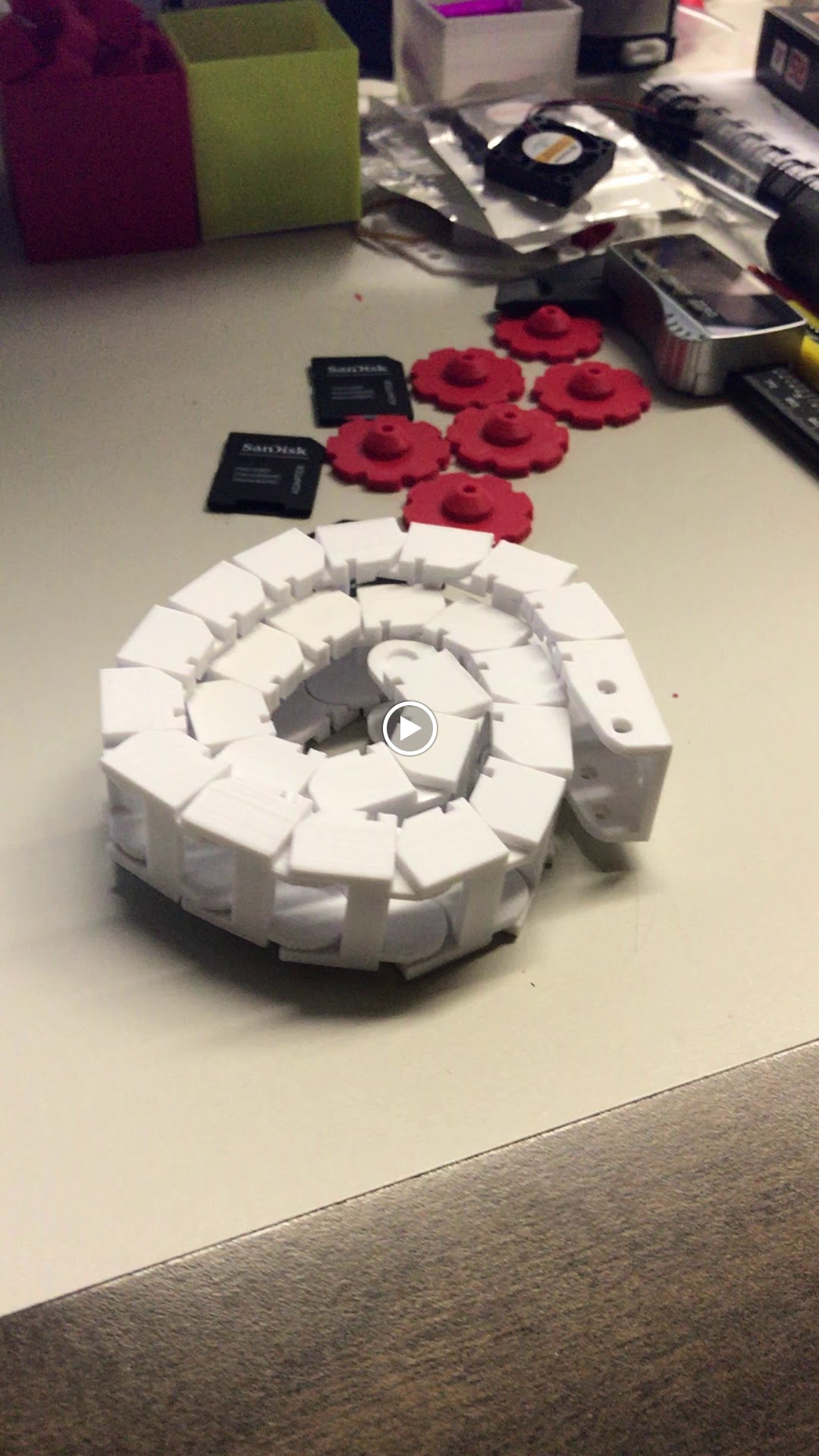

I’ll post chains from other printers.
