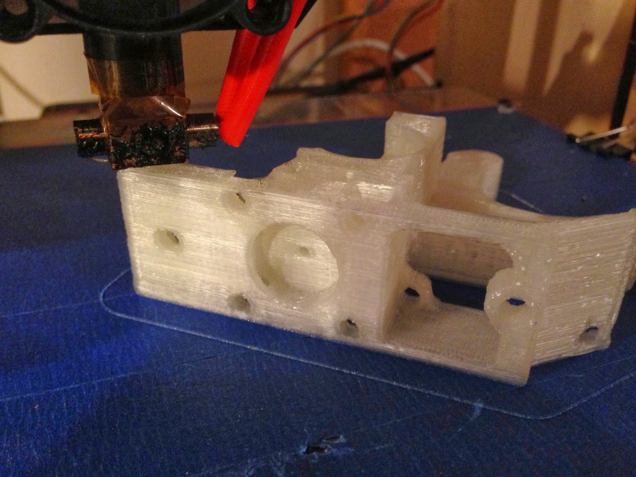

While PLA is much easier to print something so complicated as a hot end, I learned that it will become soft when exposed to heat from a long print. I believe it is a combination of convection from the hot end, and also from the extruder motor. Eventually the extruder warped and the head became loose, because the bolt holes elongated, adversely effecting print quality. After producing the parts in ABS, I have not seen the problem return. My experience was with a Wade’s extruder on a Mendel90 with Jhead hotend.
