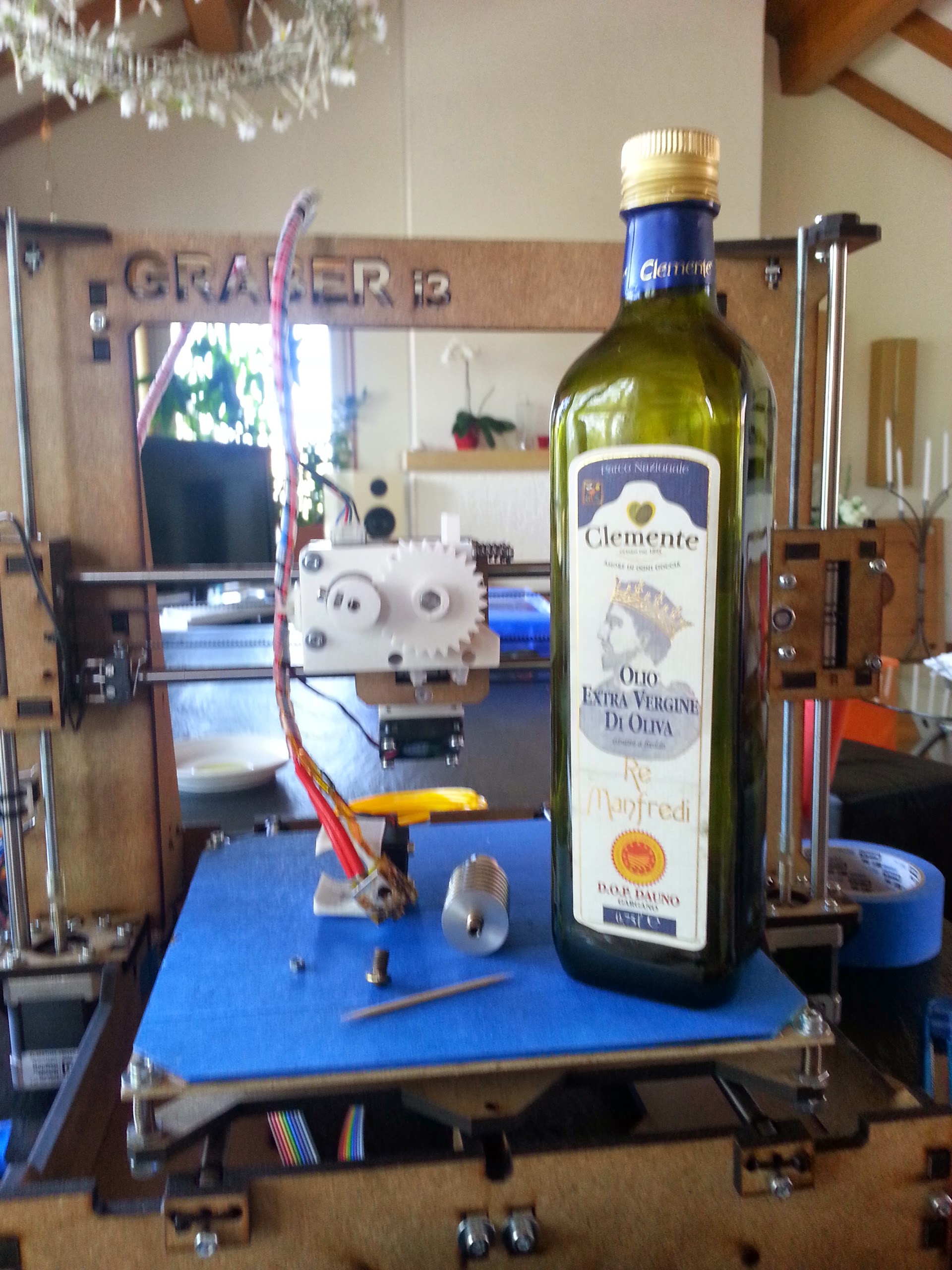

Printing PLA with the E3D: Today I disassembled my home made E3D hotend,
Today I disassembled my home made E3D hotend, spent some time cleaning the inside of the heat barrier and made it smoother. The result was not that better - even after seasoning the hotend with olive oil. I still got material flow problems. :frowning:
How about replacing the stainless steel by teflon? As long as I print PLA, I’m fine with ~220°C.
I’m not sure how much oil would help in general with whichever issue is affecting your hotend but olive oil would definitely not be the right one to use due to its very low smoke point. Others have used canola I guess but I would think silicone lubricant would make for smooth. Not sure it would be good for interlayer adhesion though.
I’d suggest that you check the wall thickness of the heat break. Did you use stainless steel for that part?
A teflon rod would probably be too soft to restrain the heater block properly, even tough I think it should work from a thermal standpoint.
@Brad_Hopper the idea behind olive oil is to ‘season’ it. similar to how cast iron pans are seasoned. however I did read somewhere that linseed oil might be better for the job.
Canola oil is what I use. Torch it, brush it clean, drop it while hot into a little canola oil. Wipe away residue & excess, reassemble. Then after assembly put a small drop onto filament scrap. Run it up and down fully assembled (cold) hot end. Install. Bring to temp and purge 200mm of filament to get any oil out because the oil kills my adhesion. Wipe off bed. Print.
Since I did this I’ve had zero jams on my E3D on pla.

@Thomas_Sanladerer Yes, it’s made of stainless steel. I took a M6 screw and machined it on a lathe. Perhaps the approach from @Adam_Thorp could work.
