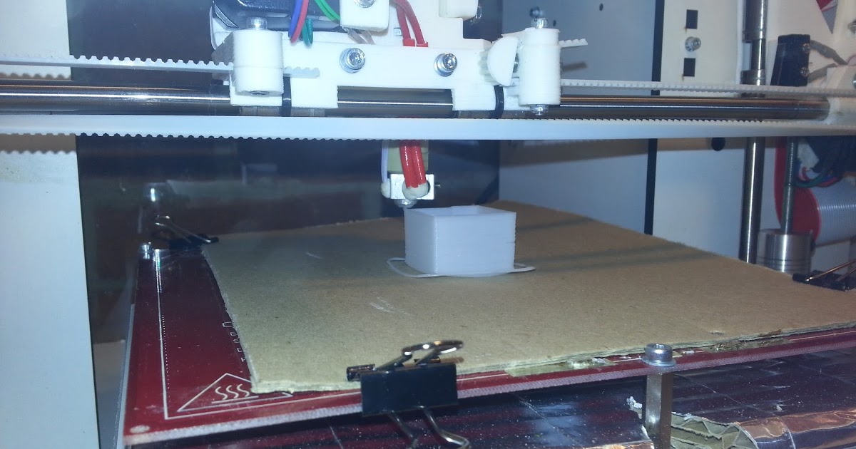

@Joshua_Rowley and I have been having a crack at printing it, as I’m really interested in using it for plain bearings and the like. It’s really nice looking stuff, very shiny, nicely extruded filament, extrudes beautifully at 250C or so, bonds to itself very effectively.
However, big issue is that it doesn’t stick to anything very well. First port of call was to go for UHU Stic, which works for ABS/PLA/Bridge/PS/NinjaFlex/PC - nearly everything I’ve thrown at it. However adhesion was quite poor and I barely managed to finish a very small object with a lot of warp. Bed was at 125C
Next up - following on from what I gleaned from Tony Lock at T3DP3D:
I tried some Tufnol. No joy on new tufnol, worse than UHU Stic, even at 130C.
Next I got out some 400Grit paper and had a good go at the surface to really rough it up and expose the fibres to get the stuff to bite. This was the most promising approach and I managed to print @nop_head s cal.stl from the M90 Repo with what I would call “mediocre adhesion” and warp that was “pretty awful”. Could do with some more quantifiable terms here, but you get the idea. This was on a bed at 135C now, but Tufnol is a poor conductor so the top surface was probably cooler.
Next steps are to really really rough up that Tufnol and use a big old raft/brim. Then perhaps look at heated chambers to combat warp.
I’ve also some Delrin/Acetal 30mm thick sheet that will be my last resort, I expect the print will weld to the sheet effectively. Perhaps careful use of a sparse raft will even allow separation of the print from the sheet.
I’m all ears to suggestions on how to print this as it really is promising in terms of extrusion and properties, but without a surface it’s a non-starter.

Overall I think my next port of call will be some 3mm Acetal sheet that will be heated, and then a raft extruded at a temperature such that it adheres enough to resist warp but should hopefully be detachable with a craft knife/spatula type object. Then print the object on top of that at full temperature. Hopefully this will be reusable to an extent. Worst case scenario I have to print parts where the sheet becomes a permanent part of the object - for the applications I have in mind this is fine. After that I’ll look into more reusable methods.
