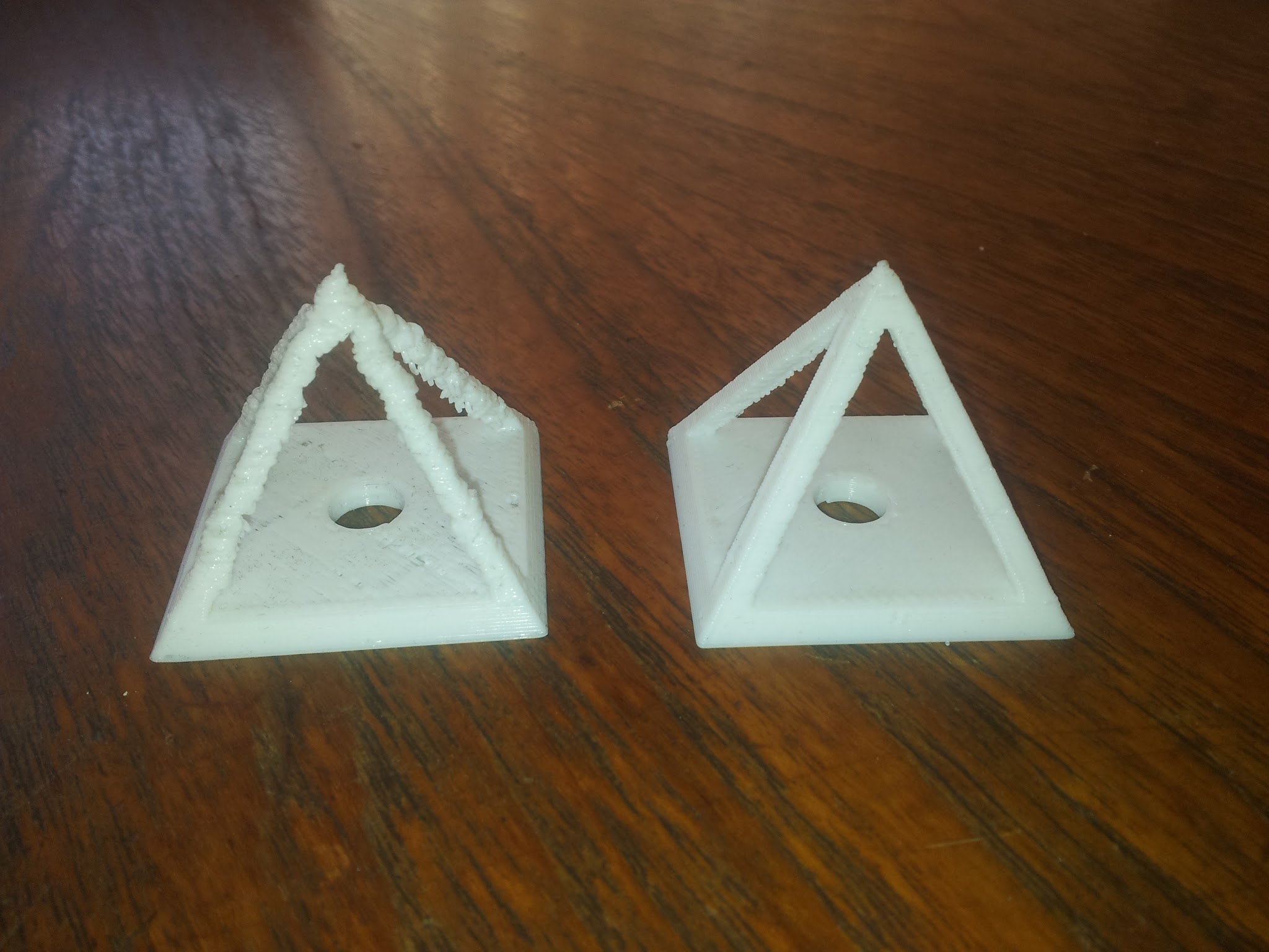

Printing with and without a fan (left image without), pla not given a chance to set. I use a standard house fan manually which on after the first 10 or so layers. A must for all small part printing.
Vois le bien that Il Faut utilsant non coulée vantilateur réusire l’impresion
I do the same, too! I stick a Vornado fan right up against the printer and let 'er rip!
Hey @Sandblastcity_Blackp , which object is this on Thingiverse? I haven’t come across it before, it’d be great for helping to get my printer dialed in more.
Hi john, it’s on thingiverse, will try and get the link for you. It’s a good test piece for printers…
