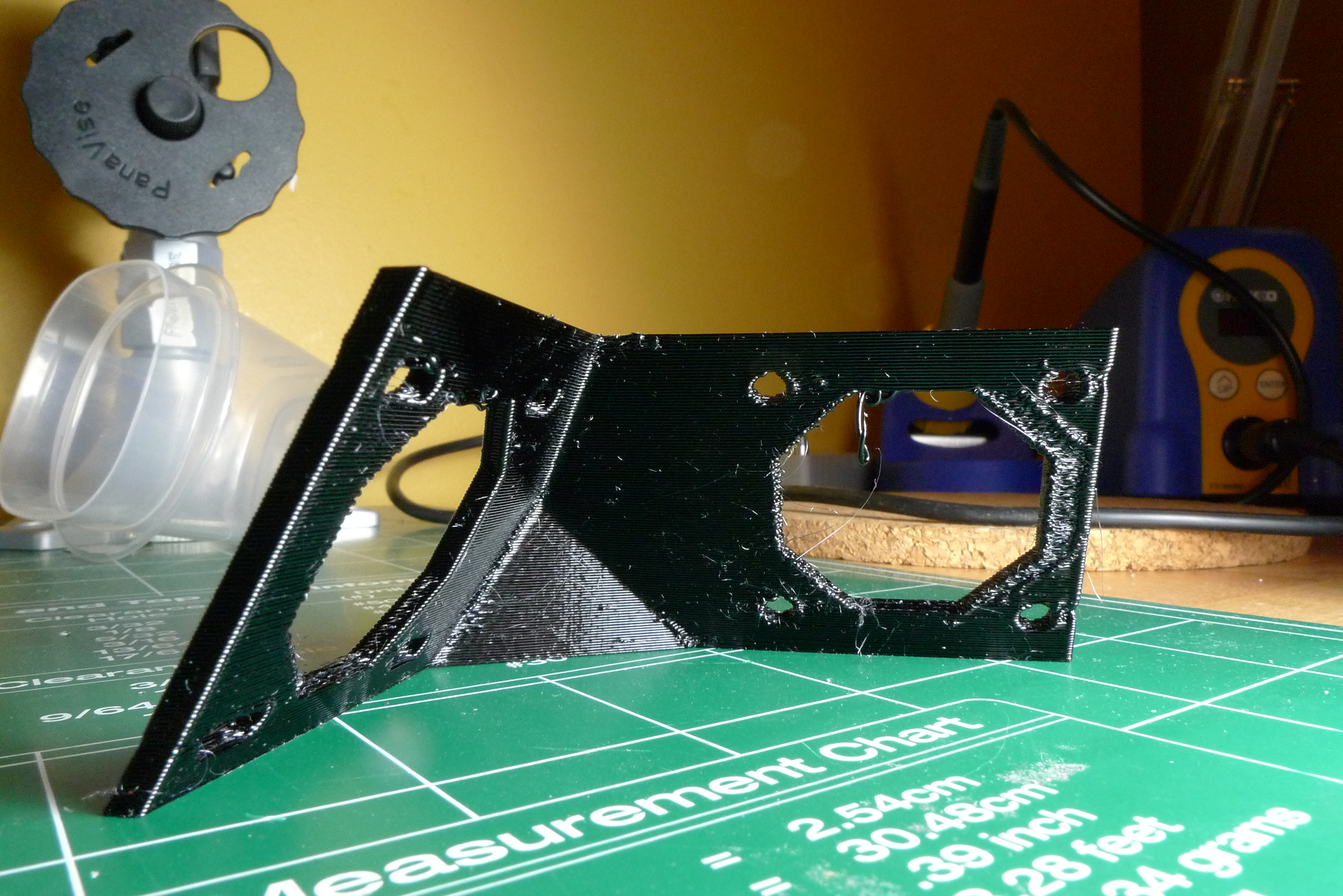

Printing with eSun PETG on a Simple Metal (Ceramic Ubis) with a 0.6mm Nozzle – really struggling to get this tuned to print as cleanly as I’d like. I’ve spent days trying to fine tune my retract configuration but there doesn’t seem to be a happy balance.
I’m currently using 0.70mm retract distance, 20mm/s retract speed and 1.0mm wipe distance. I’ve of course tried more/less of all of these individually. Generally speaking my prints look pretty good except for any area where retracts there is a high concentration of retracts. I have other prints that show similar issues, but this is by far the most obvious.
Any thoughts on where I might be going wrong?

I personally do not like the air moves that the slicer is showing in the preview. I see no point in that much air moves. I also think the part would be much better turned into a folding piece printed flat on the bed with a little overlap for the one triangle that is in the middle. I personally can not comment on the PETG settings.

I don’t think I’ve tried completely eliminating wiping. I was hoping that the 0.6mm nozzle would help me combat the relatively slow(er) speeds required for PETG. Honestly on most parts it looks fine. I have a new 0.4mm nozzle on order and should have it this week.
