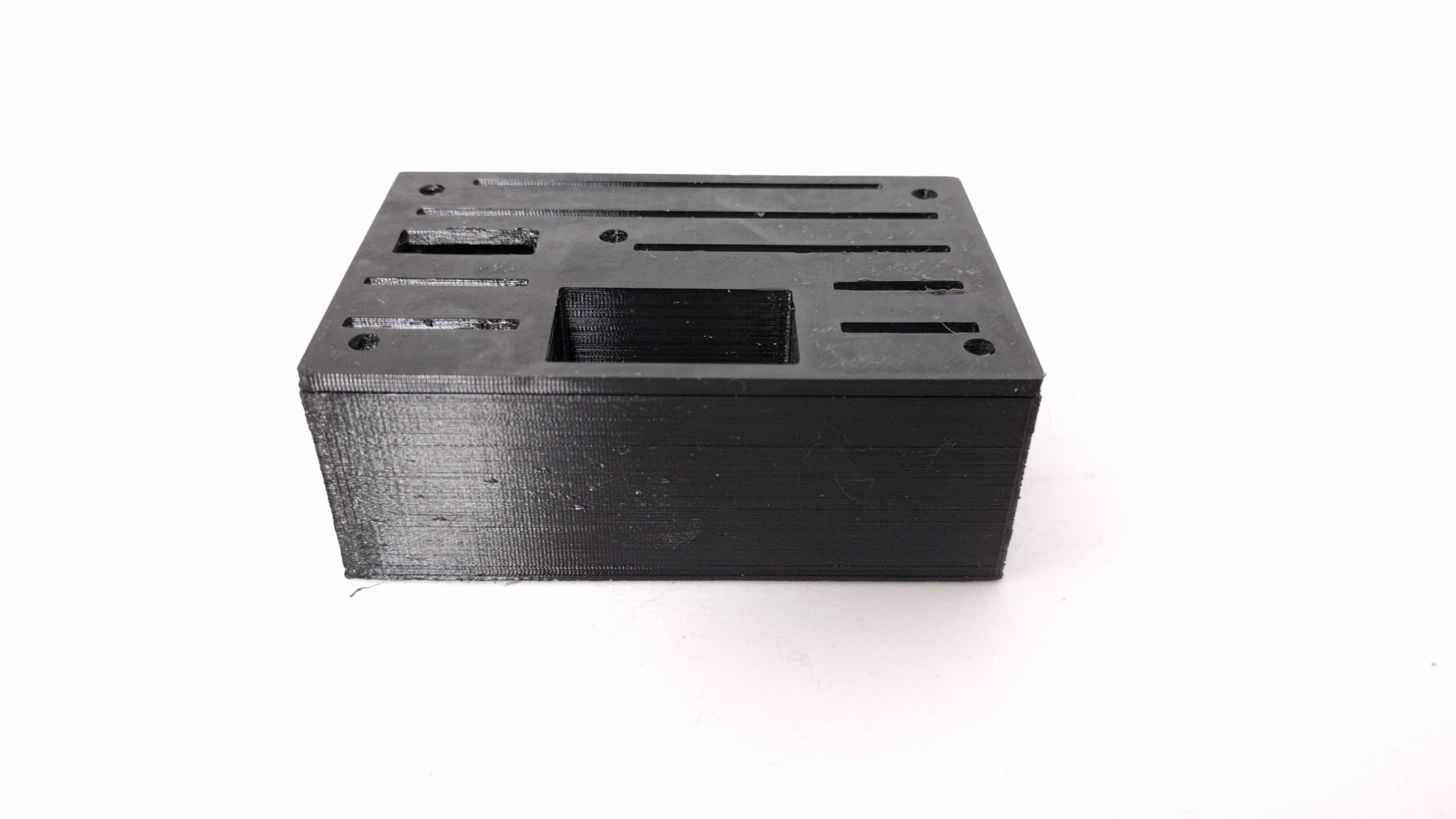

Printing with PETG, bit rough on the bridge and pillars, thoughts? 232C, 40mm/s,
Printing with #Hatchbox PETG, bit rough on the bridge and pillars, thoughts?
232C, 40mm/s, 1.75mm retraction PB Simple Metal.

If you have a cooling fan, run it on low. Keep the bed as cool as you can get away with, and possibly drop your temps a small bit (I haven’t printed hatchbox PETG specifically, but I’ve printed a ton of atomic PETG).
Overall it just looks like it was probably too hot overall. Needs to cool before you go back to the same spot, or the current layer disturbs the previous layer that hasn’t cooled yet.
PETG doesn’t particularly love super high acceleration/travel speeds either simply because it wants to string if you do quick travels (from lack of viscosity).
If you’re having issues with it balling up on the tip of your hotend and depositing chunks of it elsewhere, pick up some krytox and rub it on the hotend and it’ll keep you blob free for a few prints.
Unfortunately PETG always does show your imperfections quite well. It’s a great material but definitely doesn’t always make beautiful prints.

@Mike_C Fan was on 100%, bed was @70C. Will try your tips there.
It did seem too hot, though the roll said 240-260 and I assumed 230 was already too cool, though I’m not having extrusion issues. I will try cooler and slower on my travel moves; I think I was about 70mm/s.

@Michael_Johnson thanks, will be trying lower temps, seems like the key here.

If i’m printing PETG very quickly i’ll go high with my temps, but I try to stay as low as possible without affecting the strength of the part.
Ultimately the glass trans temp of PETG is ~77c and 230+ is quite a ways above that, so it needs to drop from 230 to a point where it is no longer soft to be disturbed by the subsequent layer

It’s also possible that the PETG is damp, and therefore needs more heat to overcome that. I have noticed that before, and got far better results after drying the filament.
