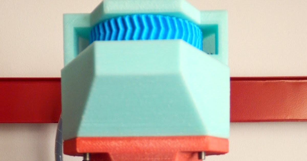

Out heater cores are custom made by us (Carl & his team). Hand wound nichrome wire wraps around an aluminum core. The heat is very close to the threaded brass and, thus, the plastic. I have a dual core, 24v (two (12v cores in series) 13s with a longer melt zone now… Testing on the Big-E. It works like a charm but may benefit from running the first core on the bed heater at a different temp at 12v and running the bottom core on the hotend heater at 12v. I do think different temps will improve it… At least two thermistors will help as the current set up has some wander between the two cores. It’s currently only taking the temp on the bottom one.
