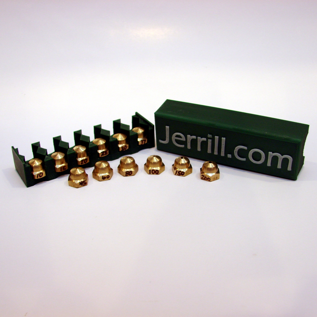

Printrbot nozzles for the serious experimenter! 0.10 mm (EXPERIMENTAL), 0.15 mm, 0.20 mm, 0.25 mm, 0.30 mm, 0.37 mm, 0.45 mm, 0.60 mm, 0.80 mm, 1.00 mm, 1.50 mm, 2.00 mm sizes included with a custom case. What does this community think? What other printers are in need of this sort of thing? Be specific with model numbers!
While both the Budaschnozzle and J-Head are widely used and compatible with many printer models, only the Schnozzle has a nozzle that’s easily exchanged. So while Lulzbot already offers the common sizes, the experimental sizes are not available at all.
On a related note, the 2mm nozzle might end up just pushing 1.75mm filament trough without melting it. But i guess it’s not meant for small filament anyways

Can you do .35 instead of .37? It just feels so prime and out of place.
@Tony_Olivo I agree. I was trying NOT to include sizes that competed directly with what Printrbot.com has for sale and it was the least “out of place” option given the drill bits I have on hand. If people seem interested in this sort of thing I’ll probably tweak the lineup a bit.
While 0.37 vs. 0.35mm might not sound like much, the default extrusion width for a 0.35mm nozzle is 0.48mm, so a 0.37mm one will be just over .5mm. So when you design parts with 1mm walls, the 35 nozzle will lay down two tracks, while the 37 will lay down only one.
