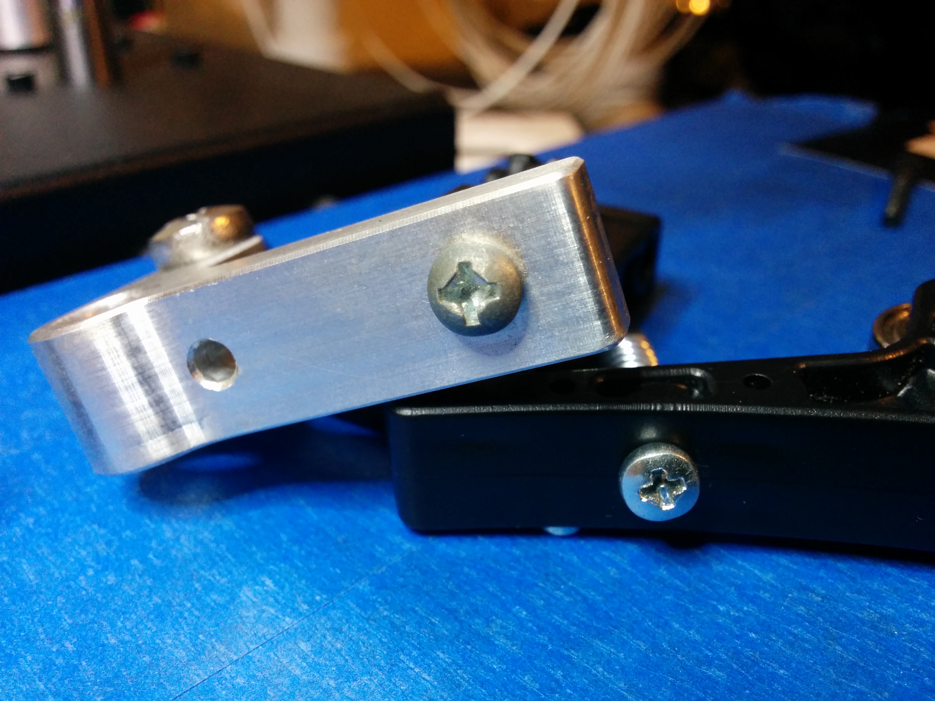

My plastic extruder arrived today courtesy of @Brook_Drumm ​​​​, and I thought I’d document my first impressions/issues here.
In terms of construction, it looks very good. Incredibly light, as you’d imagine, but feels very strong and I have no doubt it’s structurally sound. In my case all of the screws, nuts, and washers were lose in the box (the extruder body itself was bagged, however), but presumably that’s something to do with the rush to get these test units out.
Putting it together, I immediately had a problem with the tension adjustment screw. Rather than the beefy screw with #2 Phillips head as on the aluminum extruder, the plastic extruder comes with a much smaller screw. I had to use my precision screwdriver set, and of course those are hardly meant for serious torque. I feel like the smaller head on this screw is going to lead to stripped heads/tools with repeated adjustment.
Which came up rather quickly for me due to the fact that the threads seemed buggered up on my screw. It almost looks like the screw was cut down for length, damaging the threads in the process. If the screws are being cut for length (which seems strange) then the nuts should be getting threaded on beforehand.
So it seems like the hardware pack could use some fine tuning.

Screws should be socket cap, a much more reliable mechanism than the terrible Phillips screw.
I do agree the screw was a little cheap but first of all you don’t need to turn the screw all the time and second it is a $0.45 upgrade to a socket head from any hardware store.
@Stephanie_A I agree, a socket cap would be ideal.

We are 100% metric. Ok, those little plastite screws are only Phillips. I honestly haven’t considered the long Philips as an annoyance, so that was good feedback. I will see if I can find an Allen head for that one.
