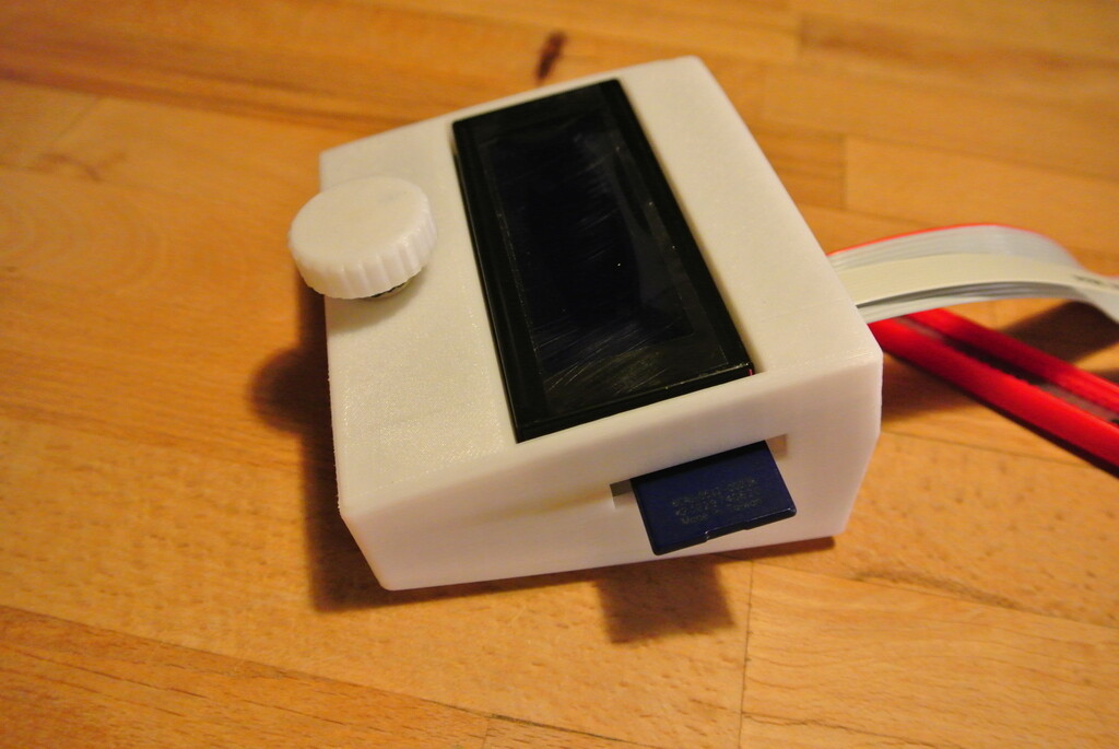

We still have some PrintrBots running in our Lab. Unfortunately, we cannot flash the latest marlin firmware to them, because we need SD card und LCD support. That means we’re kind of sticking to: Release RevF-Version-5 · Printrbot/Marlin · GitHub
Any chance that I can change one entry in the LCD menu and show the actual value of M212?
Eg: Z-Offset: 0.3mm
