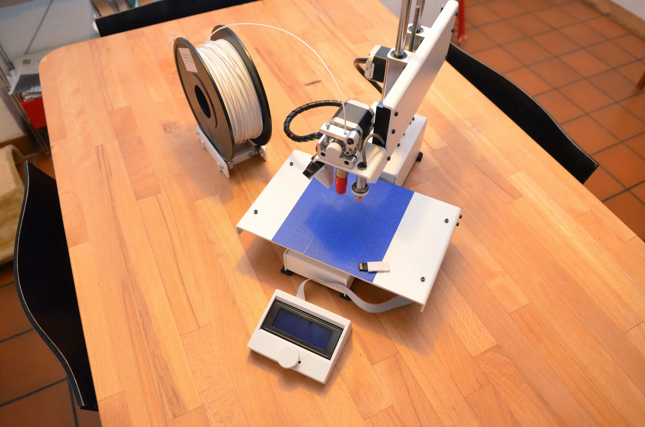

Printrbot  simple metal: Addons 1) Dampers printed with flexPLA:
@Printrbot simple metal: Addons
  1. Dampers printed with flexPLA:
    https://www.youmagine.com/designs/damper-for-printrbot-simple-metal
  2. Spool Holder for diameter 150 to 300mm:
    https://www.youmagine.com/designs/spoolholder3dp
  3. Extruder Knob:
    https://www.youmagine.com/designs/extruderknob-for-printrbot-simple-metal
  4. Micro SD Card Holder:
    Printrbot Simple 1405 Micro SD Card Holder by roijeric - Thingiverse
  5. Simple Handle Alu:
    http://printrbot.com/shop/simple-handle-alu/
  6. LCD Control Kit:
    http://printrbot.com/shop/printrbot-lcd-panel-in-stand/
6.1) LCD Housing:
If I can get the Printrbot Simple Maker’s kit to actually print strait, I’ll make some of these.
I wonder if anyone has made handle for the top for the laser cut wood version, might help make it more rigid.
Great looking setup. I’ve been debating about adding the LCD control or a raspberry pi with octoprint to mine but can’t decide what would suit me better. Seems like octoprint might have more advantages. Any thoughts based on your experience?
@Tom_Georgoulias I’m using these printers in school. By now I’m not allowed to connect my devices to the WLAN. So the LCD is the better solution.
