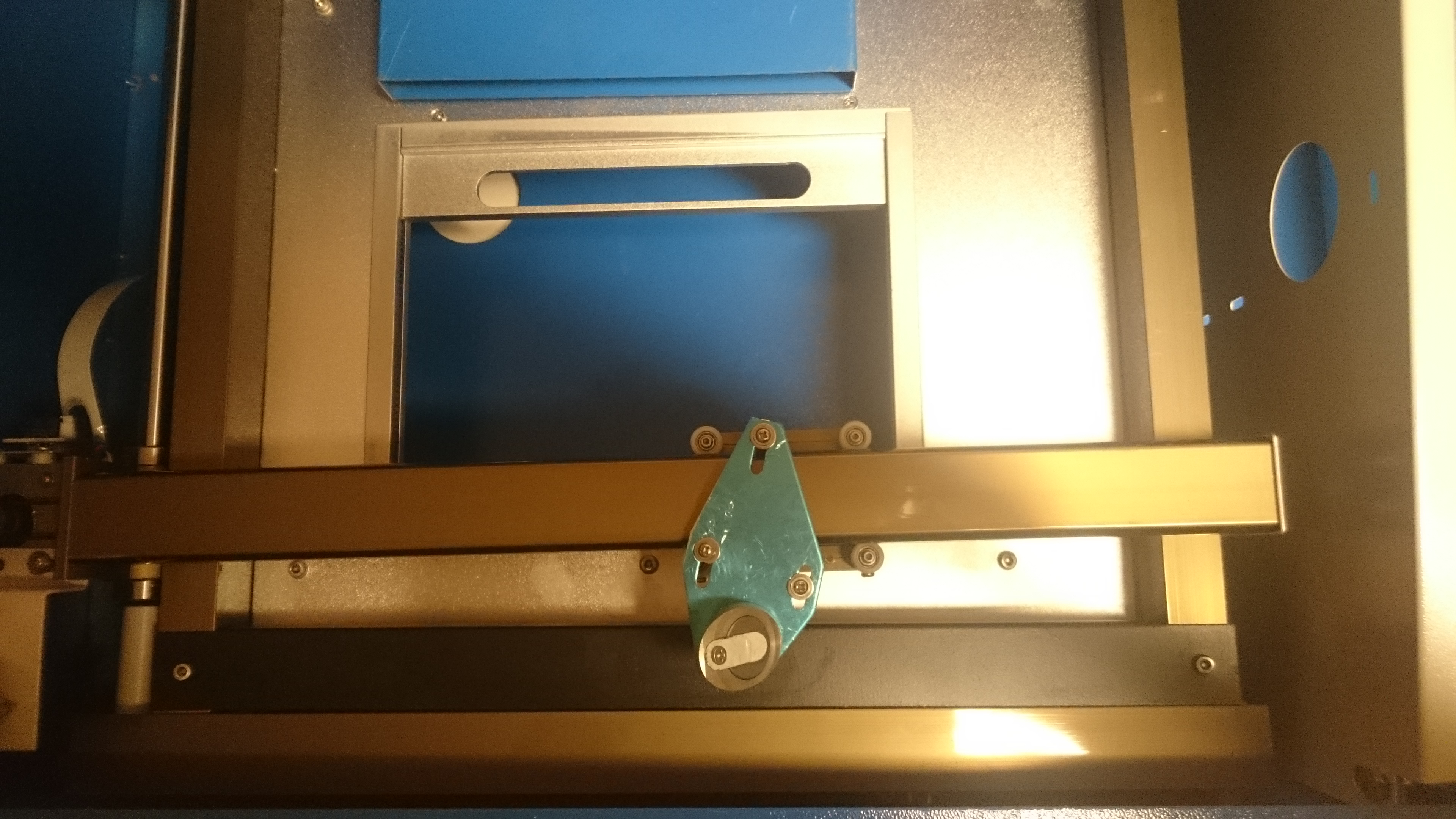

Probably a dumb question, but what is the proper way to remove (and replace) the carriage?
Remove the bed - just a couple screws. Then the frame comes out with a half dozen screws - the black piece on the front comes off first.
Make sure you unplug the wiring - either end is okay but at the board is easiest & then snake them out the hole on the right.
You need to slip the belt on the right side to fix the skew. There’s a screw on the top end of the rail that will let you loosen things up to allow you to slip the belt. The belt is ribbed and rides on a cogged wheel.

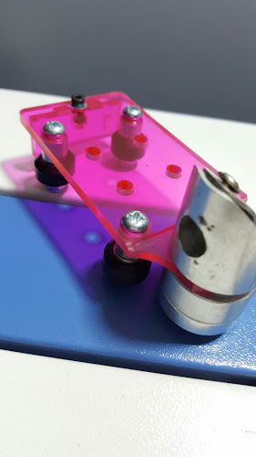

I don’t think there a proper way. Remove and build with what you are comfortable. I’m using openbuilds wheels and profiles
