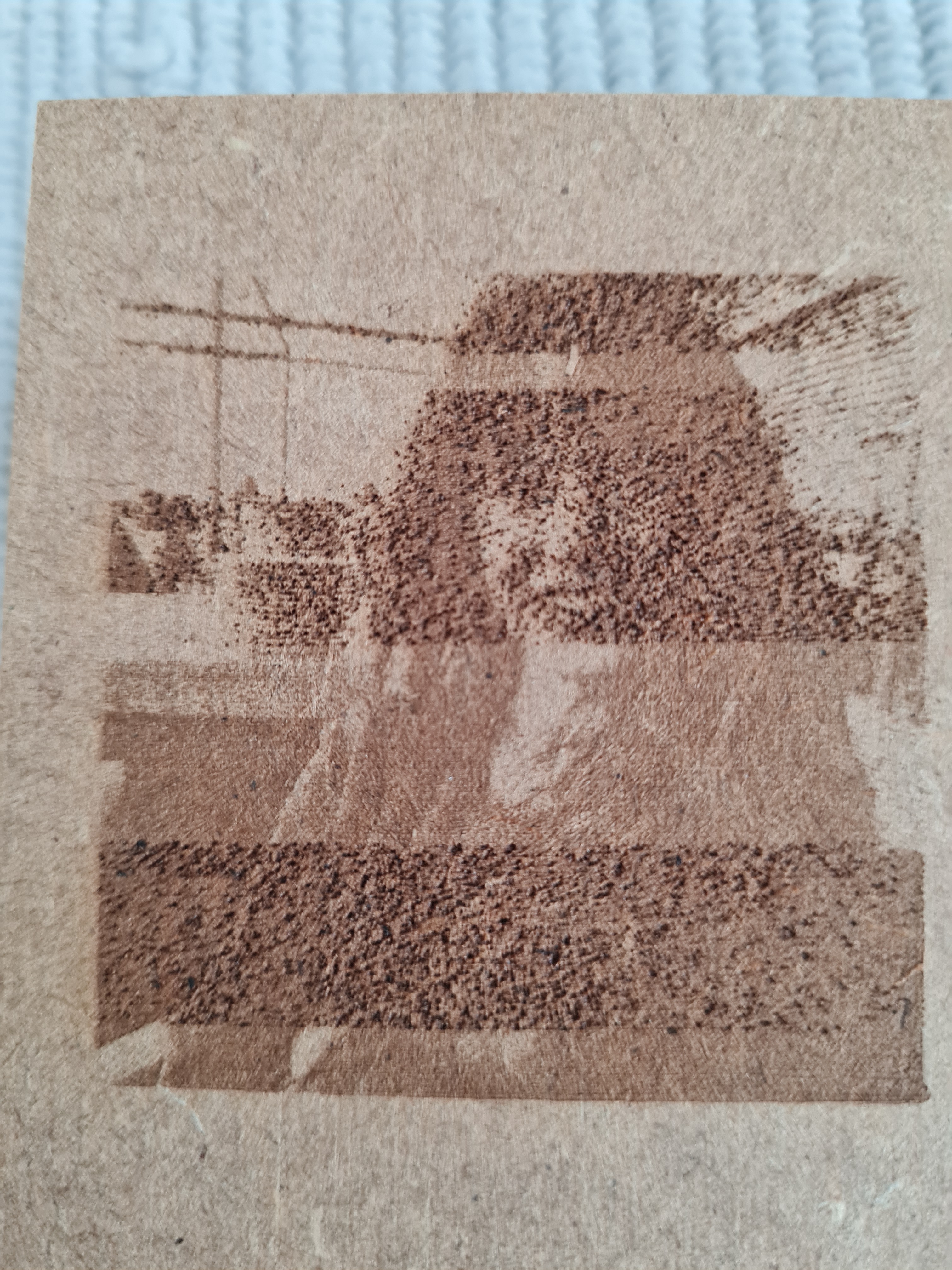

when engraving pictures on material with my X20 Pro I get these black lines that seemed burnt.
(See photo).
I used already different kind of woods and materials, tightened the belt, and cleaned the laser lens. I am engraving with the recommended settings of 3000mm/min and a power of 10-20%.
Do yo have an idea what this lines are causing?

Hi Kenny,
What control software are you using? If you repeat an engraving do the line stay in the same place or do they more around?
