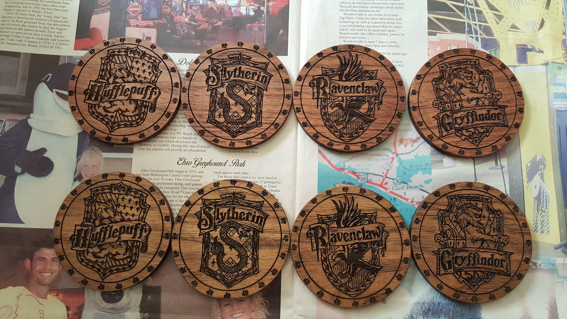

Nothing seems to help but I did find the optimum speed / power / passes combination to leave minimal charring. I’m running at 12ma at 25mm/s for 6 - 8 passes. I’ve discovered that I can make drink coasters or anything else where I can add 1mm to the outer dimension and sand it back. I made these at the suggestion a friend who is a serious Harry Potter fan. BTW, hickory really doesn’t take a stain well. The top row is a deep red mahogany stain and the bottom row is a dark walnut stain. I think they look great, though.
Nice job. Can you point me to a source file for these? I have a friend who would probably love a set as well.
@Nedman I just published it on Thingiverse. http://www.thingiverse.com/thing:2326694
Many thanks
