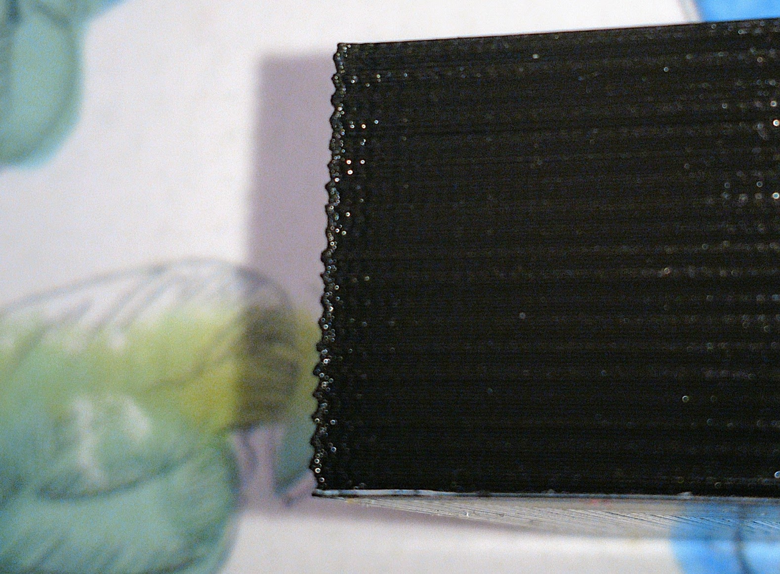

Problem with circles printed erratic like stairs.
I stumbled upon the above problem and checked for all possible causes. I never experienced this on RAMPS or Smoothie but I had performance problems in mind. Raspi load too many segements printing too fast or via USB, 8 bit limitations, known bugs in Marlin 1.1.4 none of that seemed to be the cause. I tried lowering the jerk settings and found a negative CRC when saving with M500.
So I resetted the EEPROM and changed home offset and Jerk again and it finally prints smooth circles again. :slight_smile: Just as a log for anyone that might have a similar problem.
