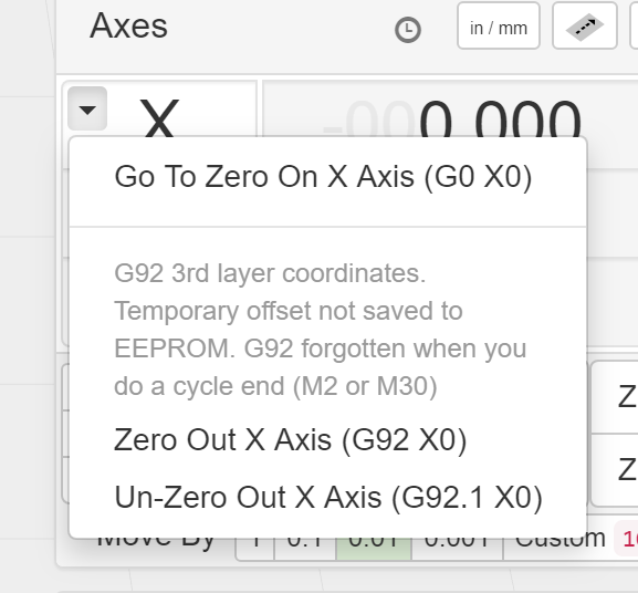

There is a pulldown on each axis that let’s you go to zero. I would use that first instead of just the generic home.
