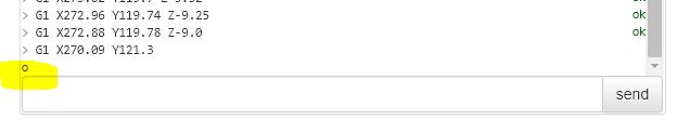

I wanted to follow up on this as I’m still having some problems. To start, I have upgraded the firmware to the latest CNC version. I have written my on simple gcode sender too and found the sender was hanging waiting for OK at random spots. During my debugging, I’ve tried a couple of other sender programs and they were also hanging randomly. One of them even shows that it receive just the “o” before it hung. Capture
The smoothie isn’t completely hanging since I can continue sending commands to it, but it will never respond with any kind of OK or other message once it stops returning data. The only way I can get it out of this state is to disconnect/reconnect (by the software) from the board.

If you are getting incomplete responses you might have connection problems. I don’t think the smoothieboard is causing this. Check it with a shorter high quality USB cable or another USB port. Even try a different PC. I ofter heard that some PC’s (like older Dell Notebooks) caused USB serial problems.
