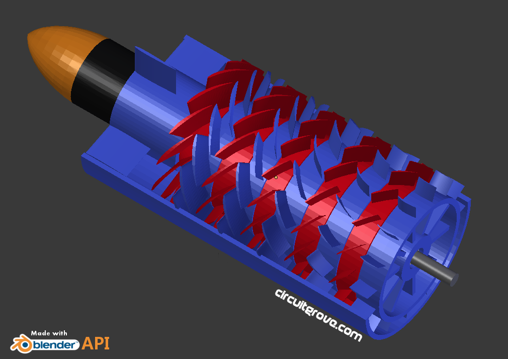

I’m thinking an aluminum shaft, 10-12cm long, threaded at one end to clamp onto the rotor and a set screw at the other to clamp onto the motor. The free end of the shaft is supported by a bearing. This is the basic concept. I will generate a dimensioned drawing when I’m ready to have it produced. Here’s a smaller version to give you the general idea. That one is used for single stage ducted fans: http://www.hobbyking.com/hobbyking/store/_4863__Shaft_for_EDF_OR003_00113_7B_8mm.html
I’m open to other ideas for coupling the rotor to a shaft and coupling the shaft to the motor.

Thanks, I like the coupler and clamp idea. I ordered some shaft couplers that will couple from the motor shaft (3mm) to the rotor shaft (5mm). It’s all coming together.
So, instead of using threads and a nut to clamp the red 3D printed rotor to the shaft by friction; I’m thinking of using one of the hubs from a jaw coupling with matching holes in the rotor. I can get a 5mm to 5mm jaw coupler (2 hubs) for ~10$ CAD.
