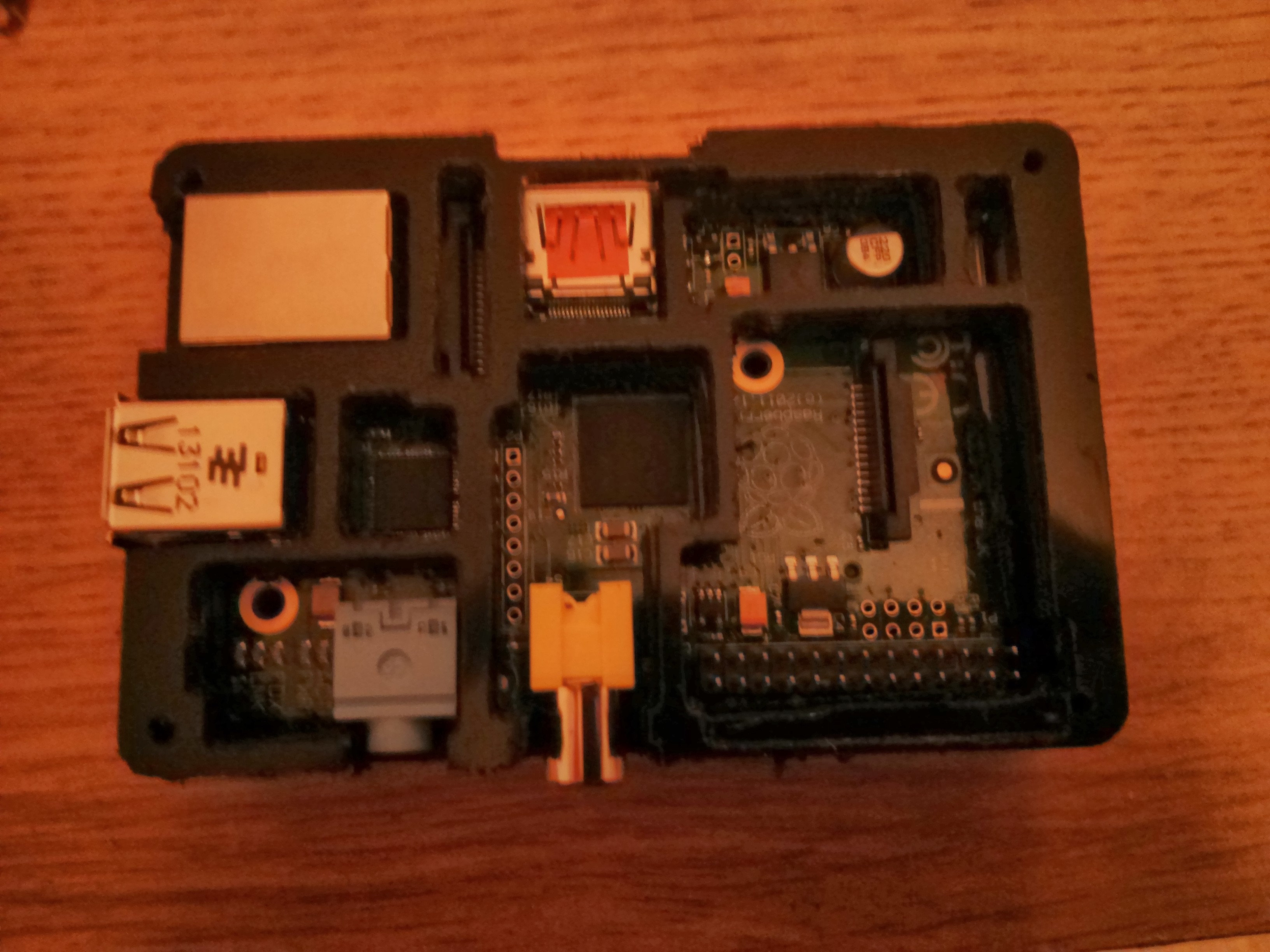

Progress is slow on the pibow multi layer raspberry pi box.
Feel like I’ve managed to trash at least as many attempts as I’ve had successful. It’s been a slightly frustrating day.
The results are looking pretty rough at the moment, planning to sand the exterior smooth one all layers are complete.
On the bright side I’m getting some fairly consistent cuts. But the hdpe flexes a little once most of the shape is cut out. And I had a few failures with the shape coming loose too soon.
Next time you will know to add tabs to your gcode files. :smiley:
When I say tabs, I mean you will cut the majority of the outline of your part leaving short sections that you don’t cut until you have completed the outline. I am pretty sure PyCAM has the tab feature available.
@Kyle_Kerr I had tabs, but apparently not large enough or frequent enough…
