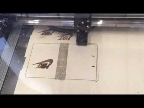

Project #1 being completed
Looks good :slight_smile: you might want to put the cover back on the head, helps keep the lens clean
Hahaha, we were testing as much as crafting!(changing lenses around regularly to test engraving consistency… The standard lens actually pokes all the way through when doing the little dots around the edge! Even at 0% power…)
:slight_smile: super stuff, in that case you really need to reduce your trickle power maybe even 0.05 :open_mouth:

0.05 was too low, inconsistent etching, esp. short bursts didn’t work… 0.06 seems to be working though
Now testing on Meranti Plex… Obviously harder material, so trying to find better settings for that…
Just for prosperity and to not mislead people: I’ve ended up back at 0.08 for consistent quality…
