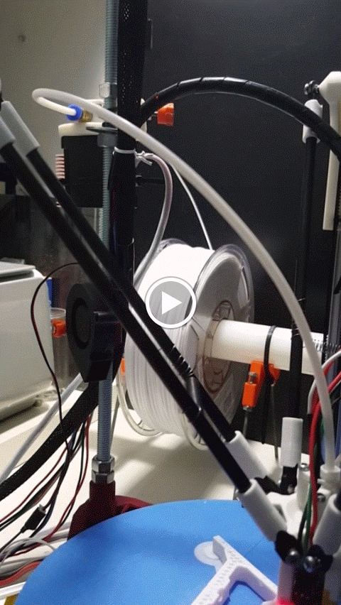

Project, 4 extruder MiltyKoss delta for the new prusa system… assembling the parts for this but not in a rush as the Prusa system was just released, let it develop and prepare for rev 2 i suppose. Start with 2 extruders and gain some experience possibly.
The extruders pivot releasing strain on the bowden tubes, already using a one extruder setup like this and it works very well
Nice! I’m actually using a similar system to mount my dual (at least for now) extuders on my Kossel XL. My rods are hard mounted to the back two sides of the frame though. If I add more extruders I’ll probably move it back like you have it. Awesome to see
@Griffin_Paquette cool! you should post some pics of a dual extrusion XL! I would love to see that. I am still very early in the pivot design stage, testing placement and how short the tube can be. Might help to see your working setup.
