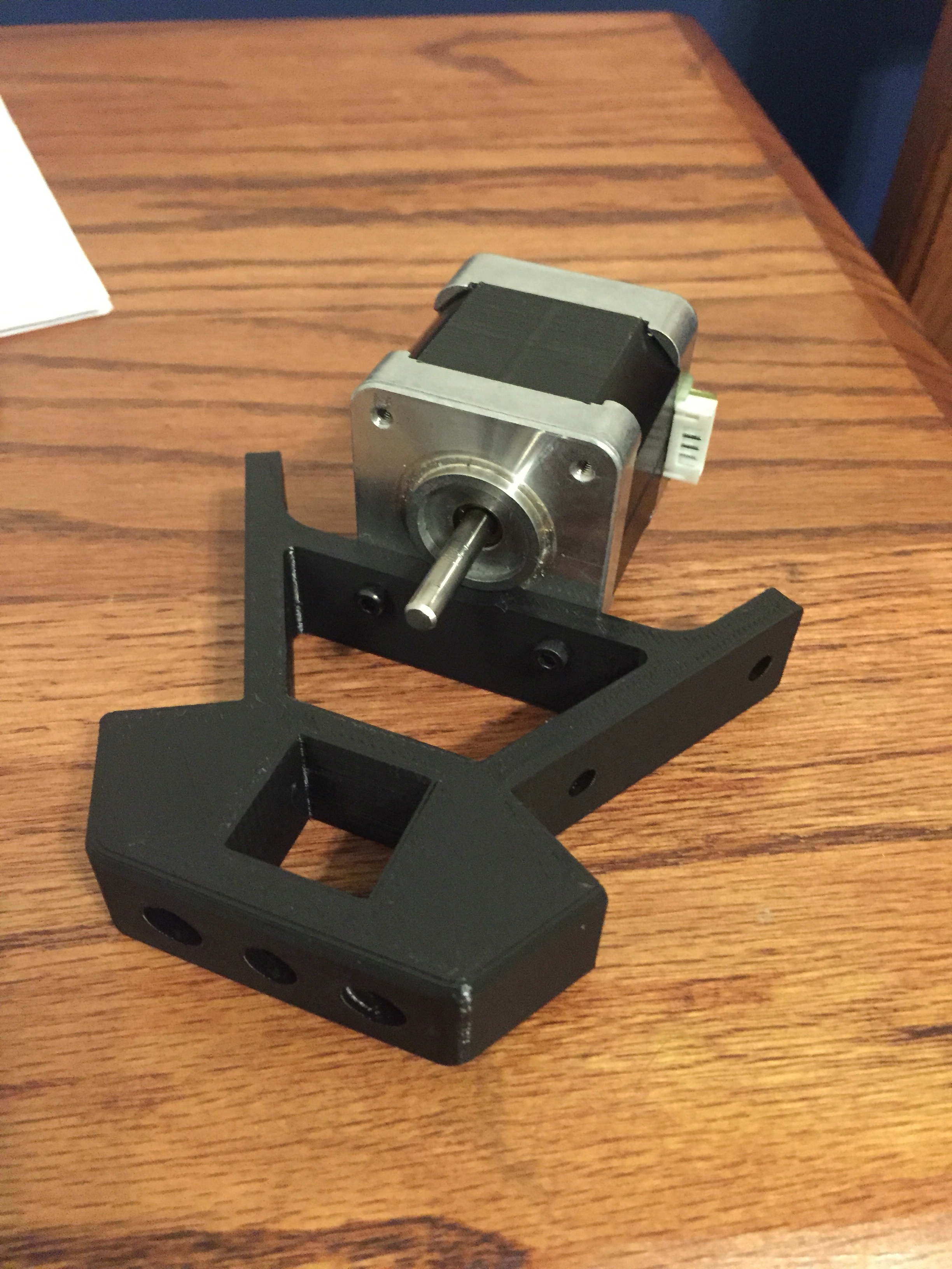

Projects have been quiet for a while but Im finally getting back into it. Just printed the first part for my delta design- the bottom mounts are split up into six parts with each being connected to the motor like this. The gap between is 20mm so one can use a 2060 for each side or just two 2020 and leave a gap.
This was also my first print with Microcenter’s “New and Improved” PLA blend. The color is slightly different between the new in the old (at least for the black) but the print quality is the same aside from a slightly diminished warping on this part. Overall still very impressed for the money.
@Alex_Skoruppa I 100% agree! These will be either PETG or ABS in the end. I had the PLA loaded and just wanted to try it for test fit.
