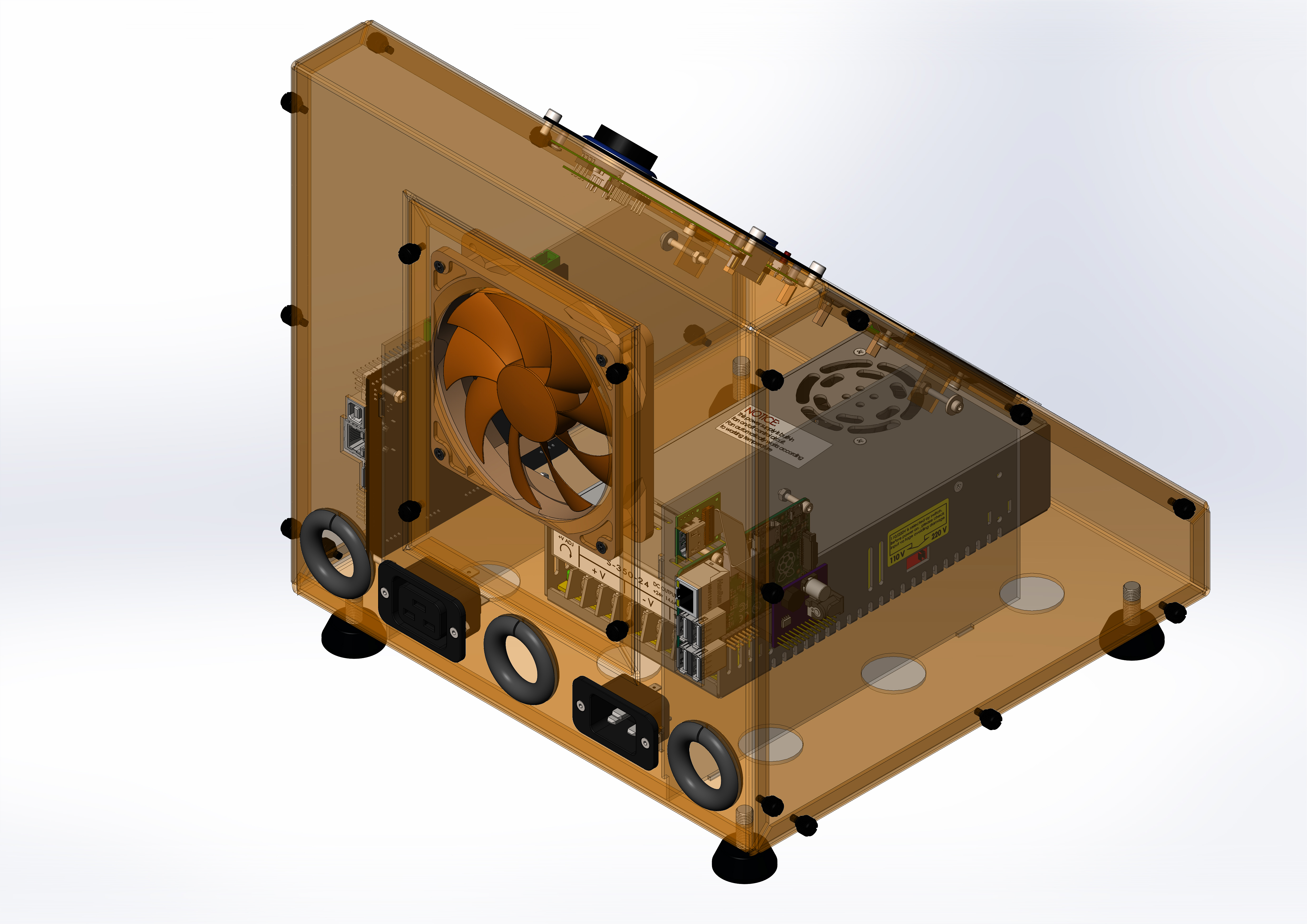

So finely on the last day of 2016, I finished my project , all electronic that don’t need to be under/over the printer now got it’s separate control-box.
Front top: rotary/click encoder.
Front lower: 7" PI touch screen for Octoprint.
Right side: Smoothieboard X5
Left side: Raspberry PI 3.0, PI power 24V version and HDMI PI-camera conversion.
Back: IEC 320 male and female for 240V power in and out to printer
120 mm slow fan and holes for varius cables.
Bottom: 24V 200W power supply and holes for air in.
All panels come off with thumb screws.
Happy New Year
