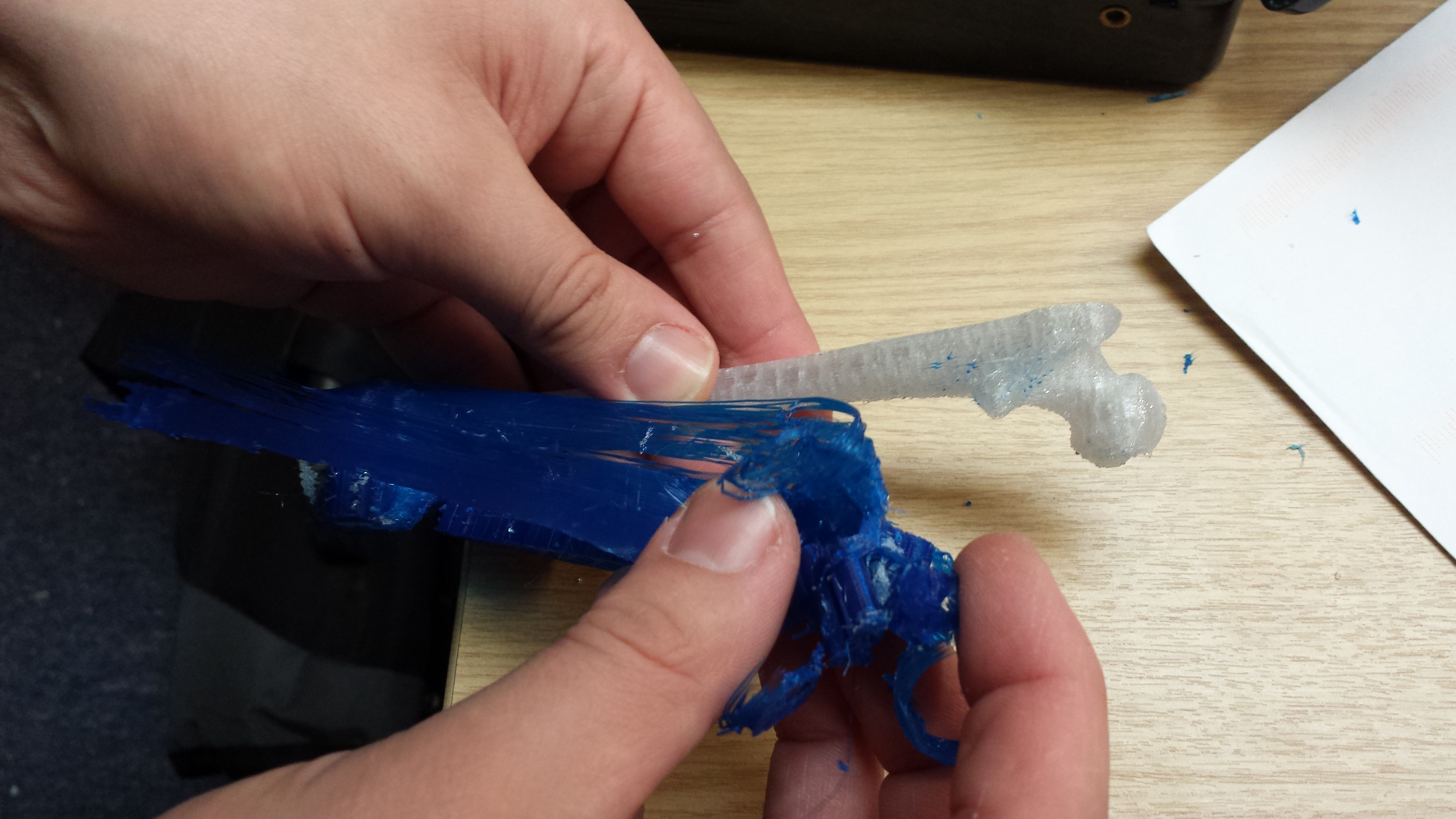

Proper support material that breaks away cleanly! This opens up some incredibly cool opportunities.
This is ColorFabb XT with PLA support material. The XT and the PLA bond nicely but as you can see in the video it breaks away perfectly cleanly.
This was printed on a Kraken/Mendel90, sliced with Cura and printed on hairspray/blue tape.
Be aware that the print stopped at 80% or so due to an electrical failure, which is why the top surface of the femur is flat/open.

Also just to point out that the pliers weren’t really needed. We removed 90% of the support by hand. Pliers just gave a better view for the video.
Cool! One questione, have you manualy drawn support or was it generated with slicer?
Generated entirely automatically with Cura.
Can the XT be used for supporting normal coloured PLA or would it not break away so well?
Yep, it works both ways around!
Nice! I get similar results with our HIPS+ABS combination. It seems like the two materials like to separate more after they have cooled down a little bit. I like color matching the supports to the print so that any remnant of supports would blend right in.
So, when I could get it extruding without jamming (oval filament ) I found tglase and ABS were the same.
Was the support printed solid or was it sparse like regular single material support?
@Billy The material was sparse - set at 25% in cura. Cura doesn’t support something like slic3rs “interface layers” between infill layers and the model.
I’ve made some changes to cura - changing the hardcoded overhang threshold to get some support where it was needed but not being generated, and it’s now reprinting. 30% support material density this time. Also not gaps between support and model. Trying to get better underside finish.
