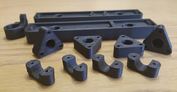

So one thing I don’t like about Google plus is that you can comment with a photo. Here is a link to some things I’ve printed with Proto-Pasta. There is the in progress of the lcd controller v2 case, the completed case installed and a fun print of the GE Jet Engine. Anything black in the photos is Proto-Pasta.
Added some prints I just did. Got the makers to play upgrade kit for classroom but it needs printed parts to complete. It’s odd, when printed at 100% infill as suggested it has a similar weight and consistency of delrin
