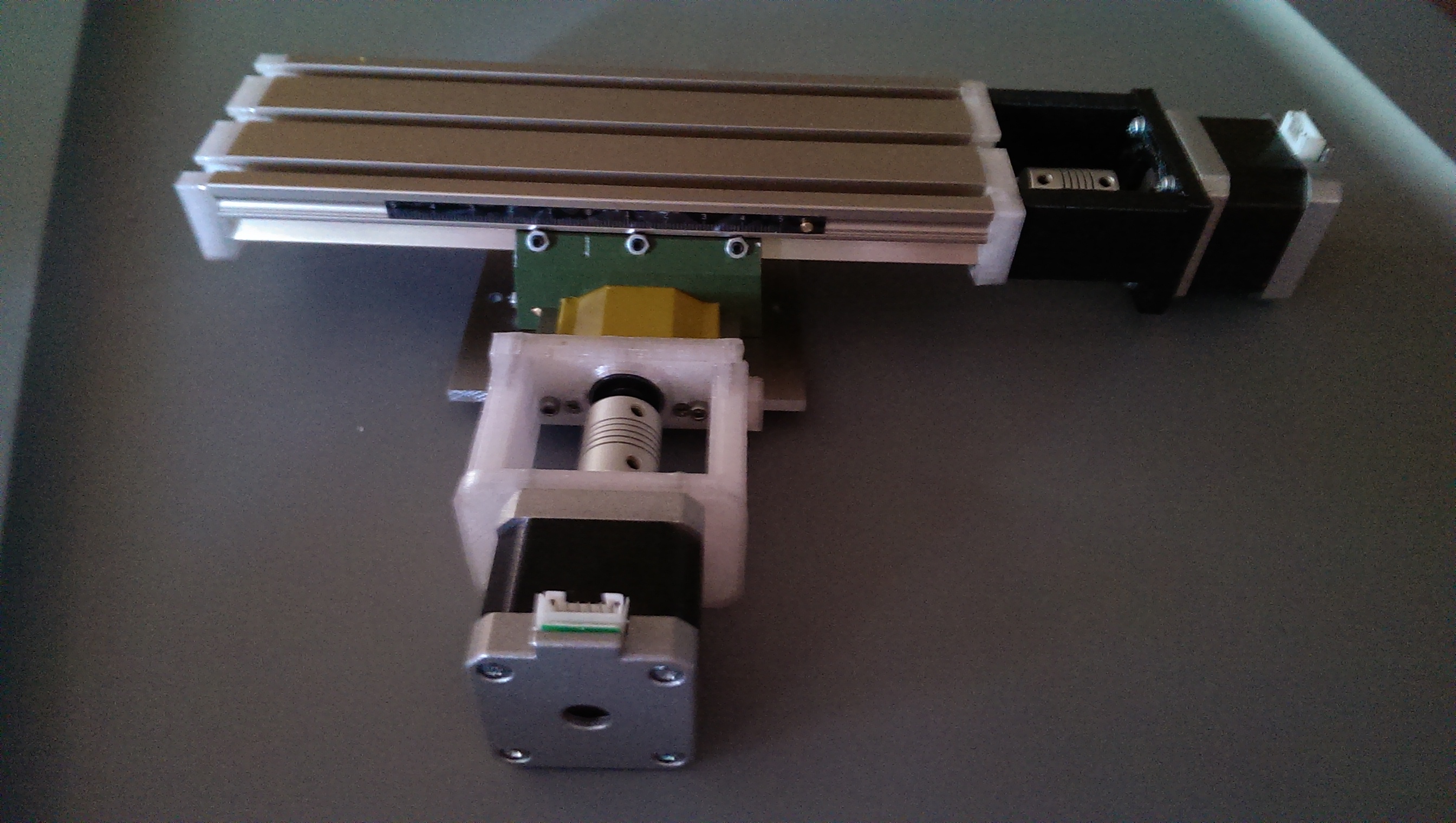

Proxxon KT 70 turned into Bubblegum CNC! Yes, next up building the chassis and attaching the Z axis.

I did an initial test of the steppers by attaching them to the x and y of one of my 3D printer controllers and using Pronterface to move the axis.
Initially I found that the long axis (X) was generating a lot more resistance to movement (perhaps double the amount of force for the short axis) and so I took a VS drill and ran the axis back and forth several times to loosen it up a bit.
For control I have ordered a Protonerr CNC card for a Raspberry PI 3 that uses GRBL. My plan is to use the 7in touch screen for CNC control. We’ll see how well that works in a dirty environment.
The Z-axis of course is a C-beam with a Nema 23. Probably overkill for a Dremel (my initial planned spindle).
