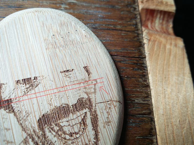

PSA: Yesterday i did some engraving and took some pictures for my blog. The auto flash was on and it messed up my limit switch optical sensor. Result: a shift in the X. I reproduced the error so I was sure it wasn’t a fluke. Not something you want to happen on a long engrave or with expensive wood :wink:
