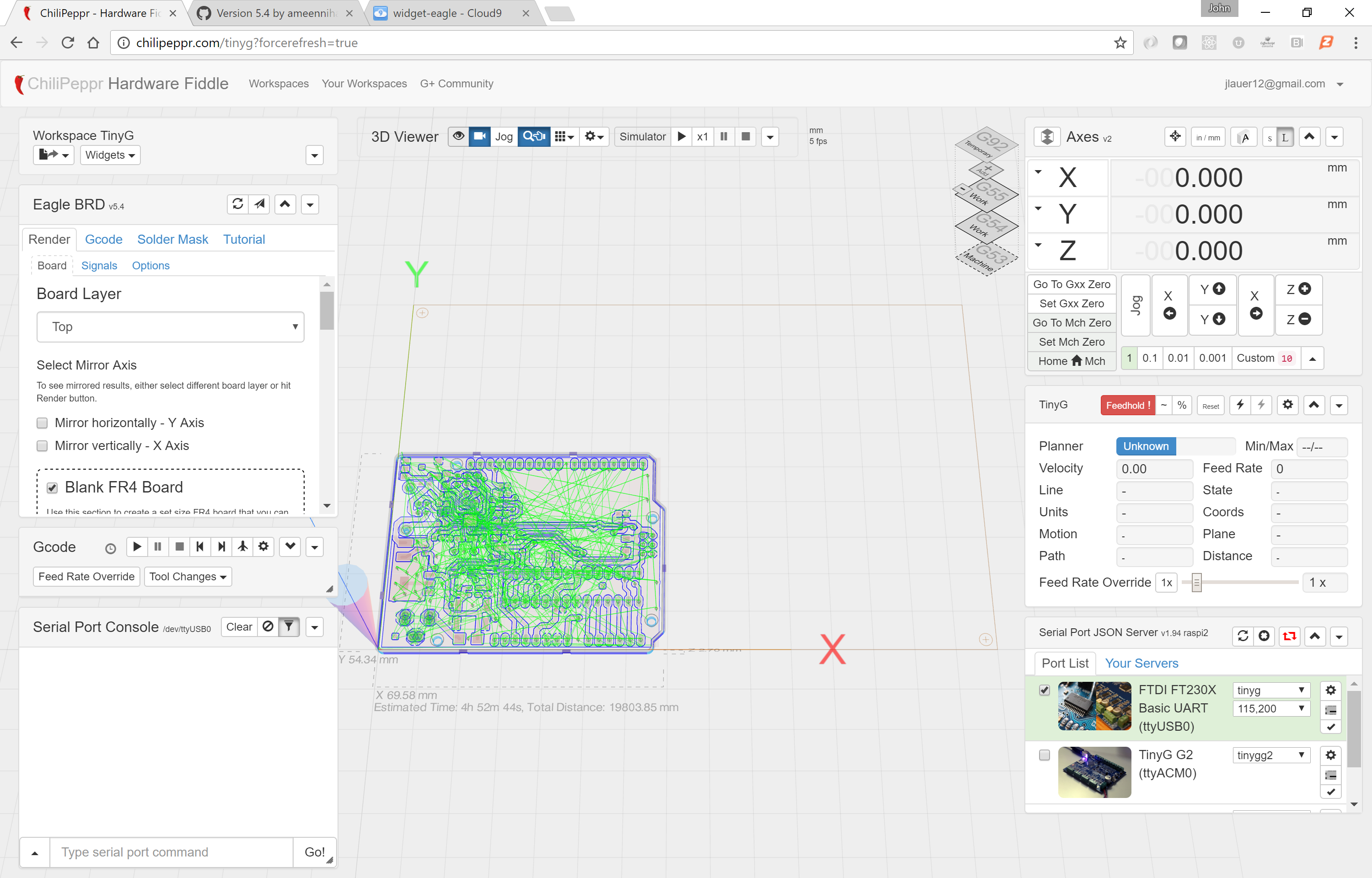

Published @ameen.nihad 's version 5.4 of Eagle BRD widget. Ameen has added an incredible amount of features with the most notable recent one your ability to mill registration holes on a set size FR4 board as seen in screenshot. This lets you flip your board accurately to mill the bottom layer.
@ameen.nihad I cleaned up some of the layout and wording to try to make things cleaner.
