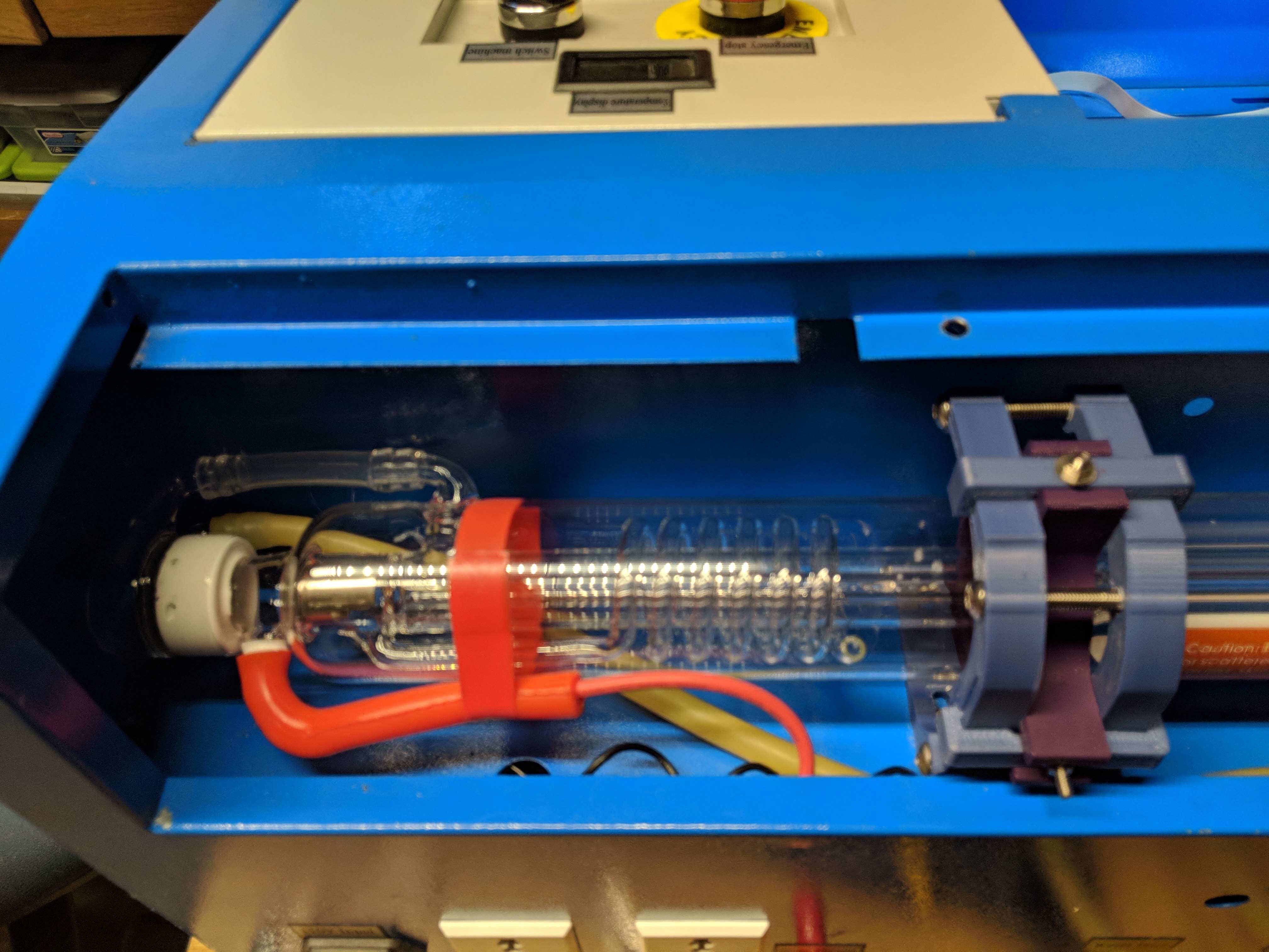

My K40 died last October, I thought it was the power supply but replacing it didn’t seem to do the trick. I then purchased a new tube from LO, installed it but now get no power (no green led).

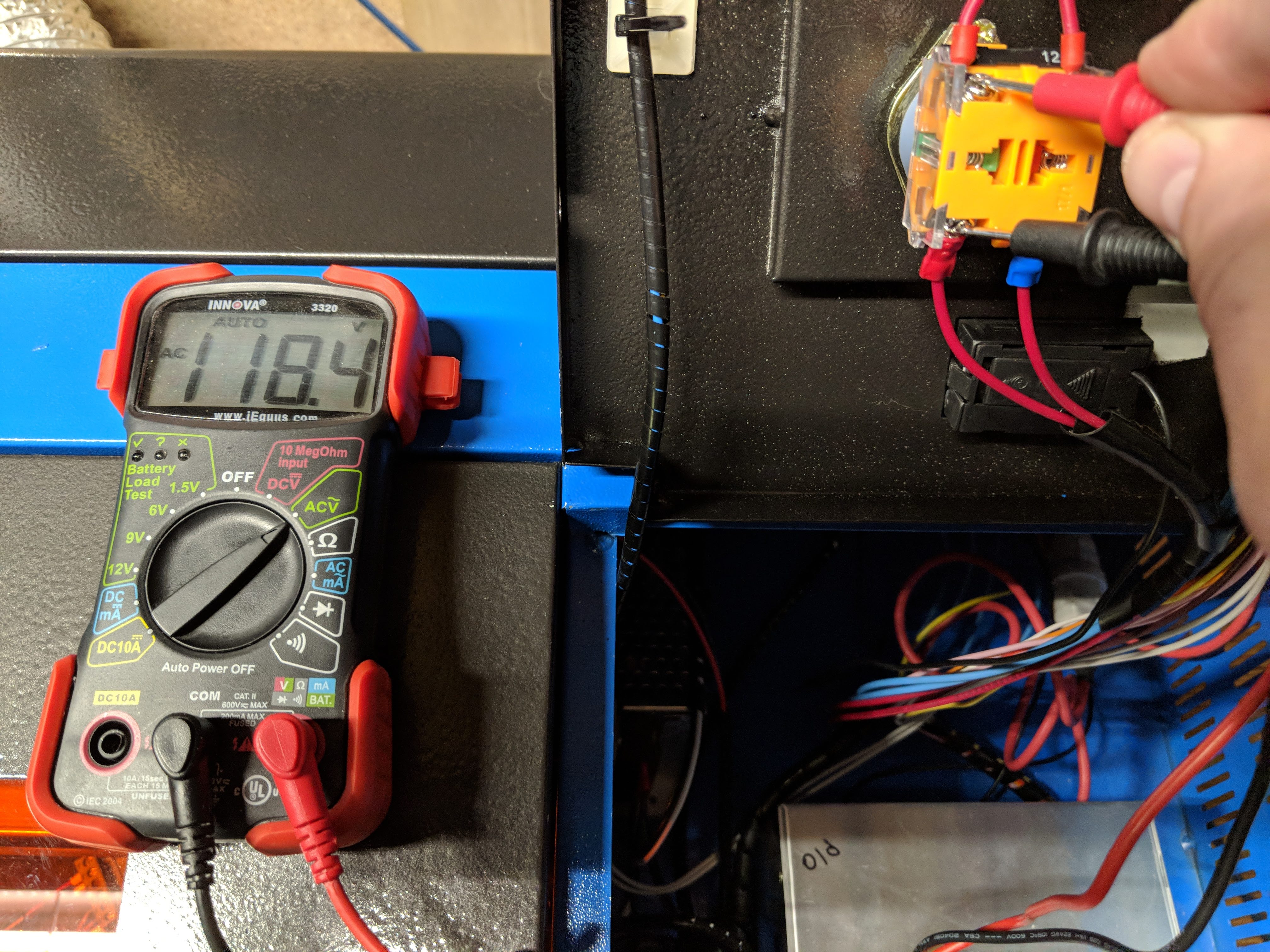

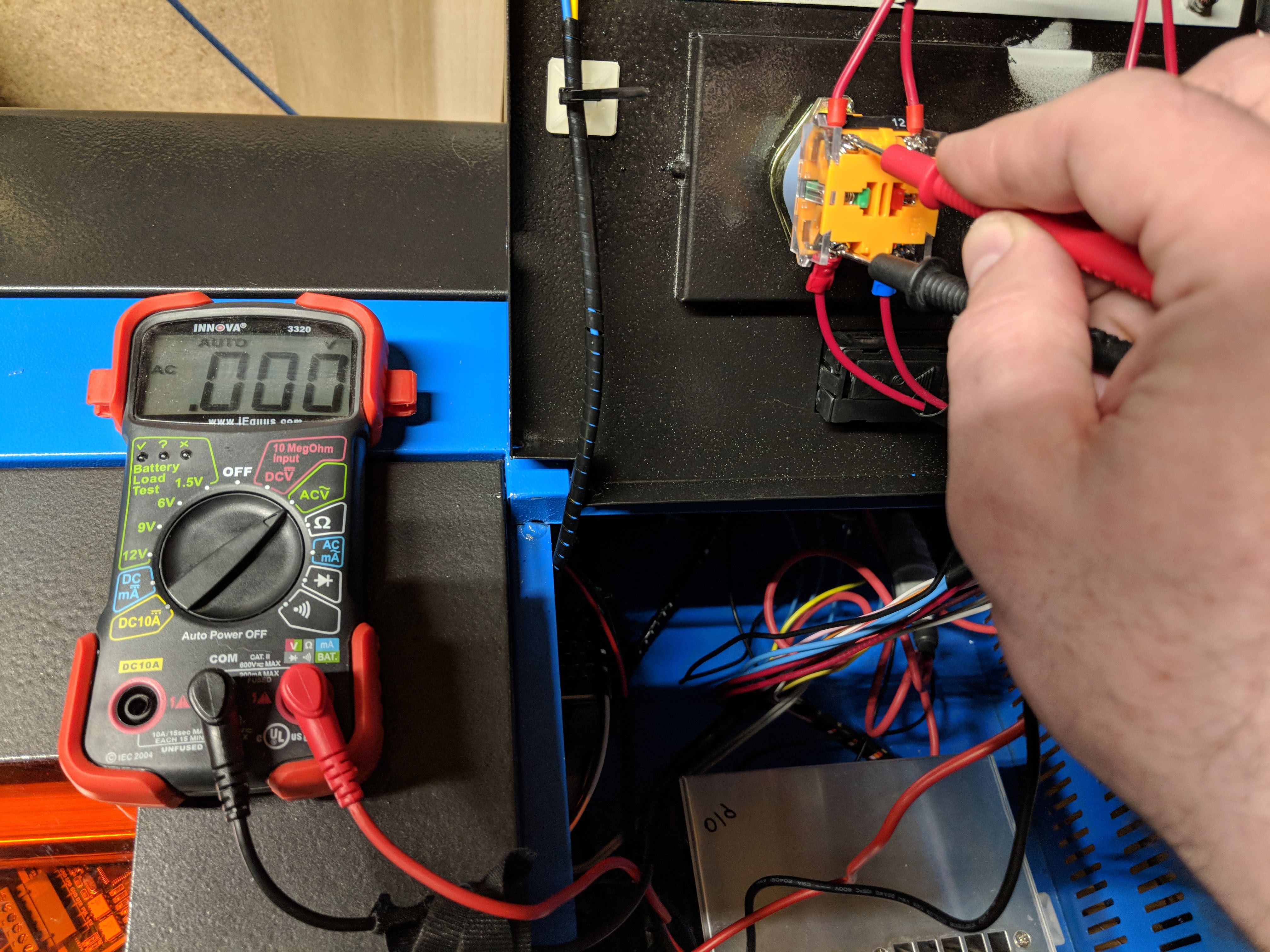

Yes, and I just tried the new supply I got today and still no luck?? The fuse in the IEC plus is good, the fuse in the supply is good, I rechecked ground. The only thing I question is if I wired the new e-stop switch correctly. But I figured I did, if I am getting 120V at the supply.
This is with the e-stop button pushed in.
Here is with the e-stop button out (run Mode)

Your measurements are measured from either side of the line to FG???
Are you running on 220v?
What does it read across AC to AC on the connector?
I am focusing on why the supply does not turn on with proper voltage to it BUT…
  • I am wondering why there is a difference in voltage from FG to either side of the line of 2.5v?

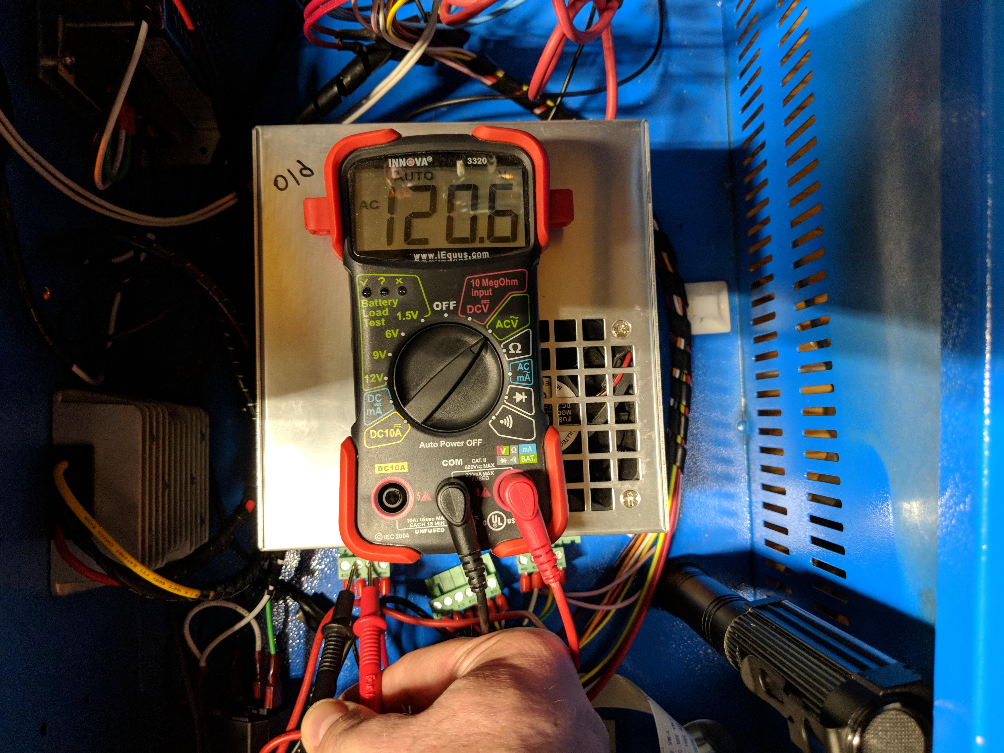

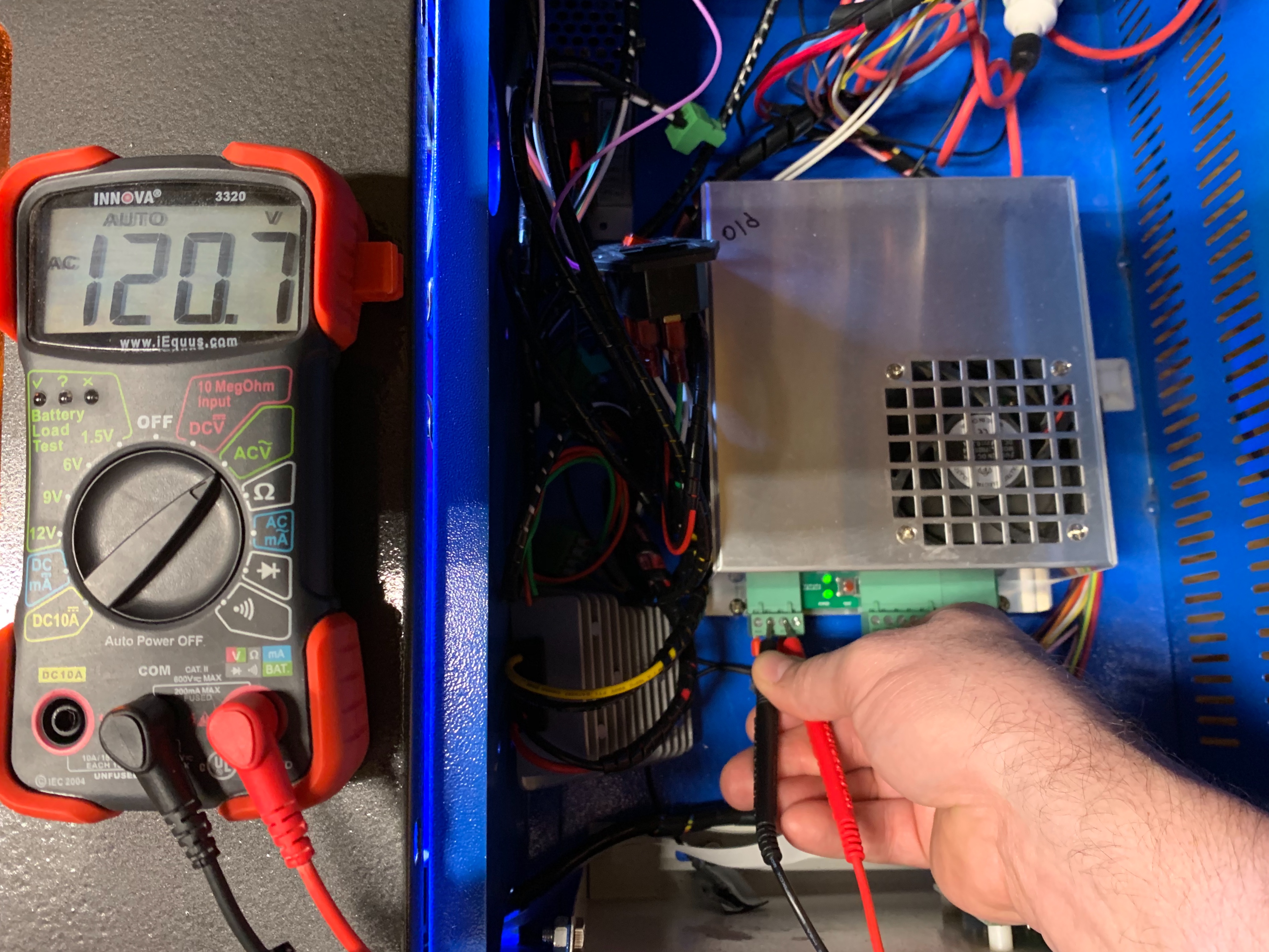

So I took readings with the correct switch (NC) in place, not really understanding what I am seeing, but it works.
Switch disabled (power on)
Switch enabled (power cut)
This shows the switch in action.
Is this running 120V service?
At least now it looks logical:
When the switch is on
  • Left AC pin to FG is 120V = Correct and this is the HOT side
  • Right AC pin to FG is close to 0 ACV = Correct, this is Neutral side
  • I would assume that measuring from the left AC pin to right AC pin would = 120V?
I assume the switches outputs are connected to the right and left AC pins on LPS right?

Yes it is 120v, I didn’t want to unravel the wrapping, but the wires come out of the bottom of the switch and go into the AC left and right pins judging by the color of the wires.
I replaced the LPS first, but that did not fix the issue, so I replaced the tube, and that got me back up and running.
Going to start looking up replacement tubes this weekend. Suggestions?
I purchased a LO 40w, I think it was $145 plus shipping. The quality seems so much better than the stock tube that came with mine. I took Don’s advice and purchased a HV connector.
