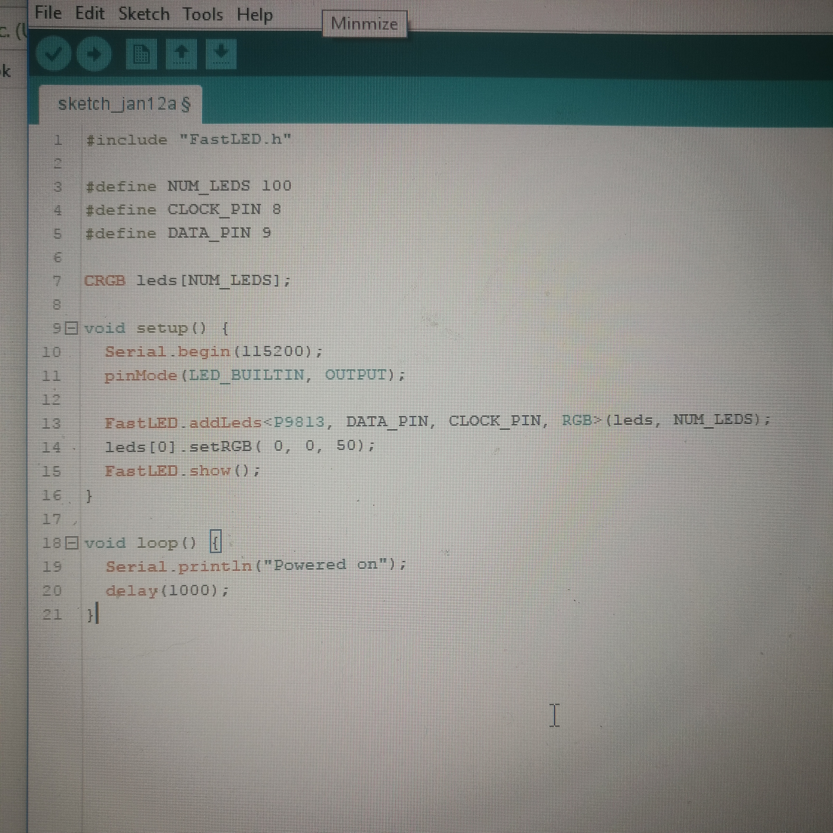

So I purchased a 2560 Mega and have the same issue I’m using a P9813 RGB controller and the shortest piece of code to test with. The Mega being powered over USB and the P9813 powered from a mains 12v adaptor.

Not that I would think I would make any difference, but shouldn’t NUM_LEDS be 1 in this case? The whole strip would just be considered a single “pixel”, yes?

I thought I had it when I realised the mega has hardware SPI on different pins, so I have switched to CLOCK_PIN 53, DATA_PIN 51 and its still the same
The strip is 5m with 300 LEDs, they are 5050 LEDs, the power supply is 5A. I have tried NUM_LEDS as 1 as well, no change.
