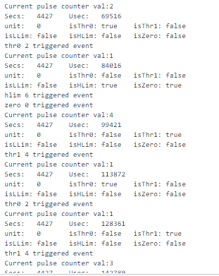

I have been testing it with a motor controller and its producing output when a triggering event occurs, but the count never gets higher than 5 even though the high limit(HLim) is set to 32227. the counter fluctuates weirdly between 0,1,2,3,4 or 5.
Yes I am using the sample code. Noise seems like a reasonable cause but ill have to test and see.
Attached is a snippet of the output I was getting in the console.
