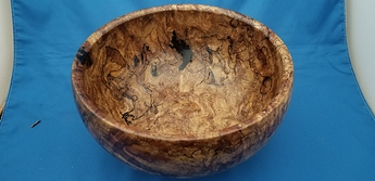

A rather difficult piece to turn because the wood was cured and “punky”. Punky means it was a spongy-powdery kind of consistency.
I had to work hold it with a glue block on the bottom and soak it lavishly with finish to stabilize it.
