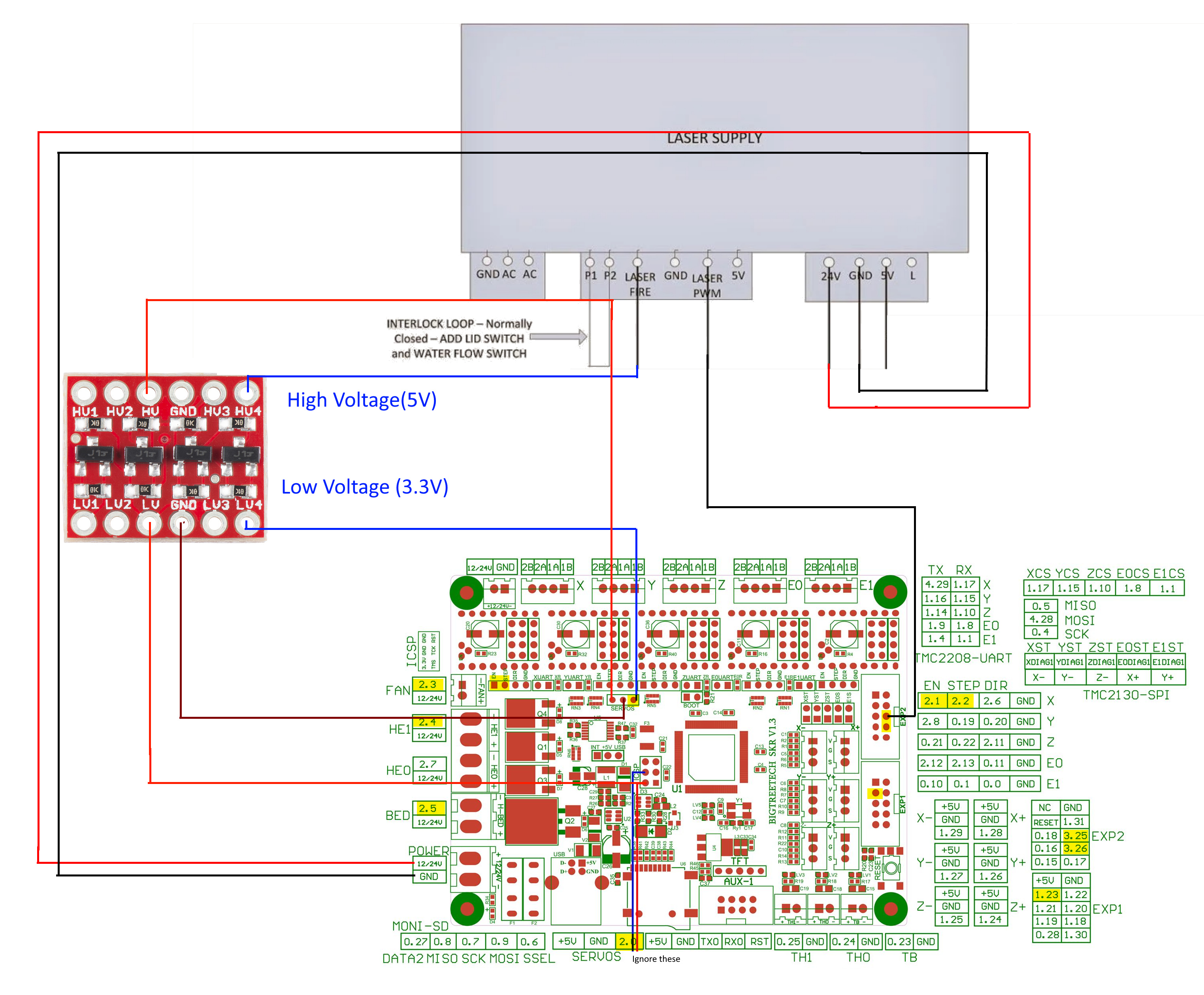

Because not works with my laser. Goes On/OFF with M3/M5 but not is capable to control the power. With servo pin works perfect.
I was searching before asking if there was a direct pin for HB_PWM, but that pin goes all the way to U5 MC74HCT125ADTR2G. So I was looking for an alternative pin, on the net I found this, which gave me that idea and it works perfect.
Also I changed $33 to 20.0. My diode laser is 20khz

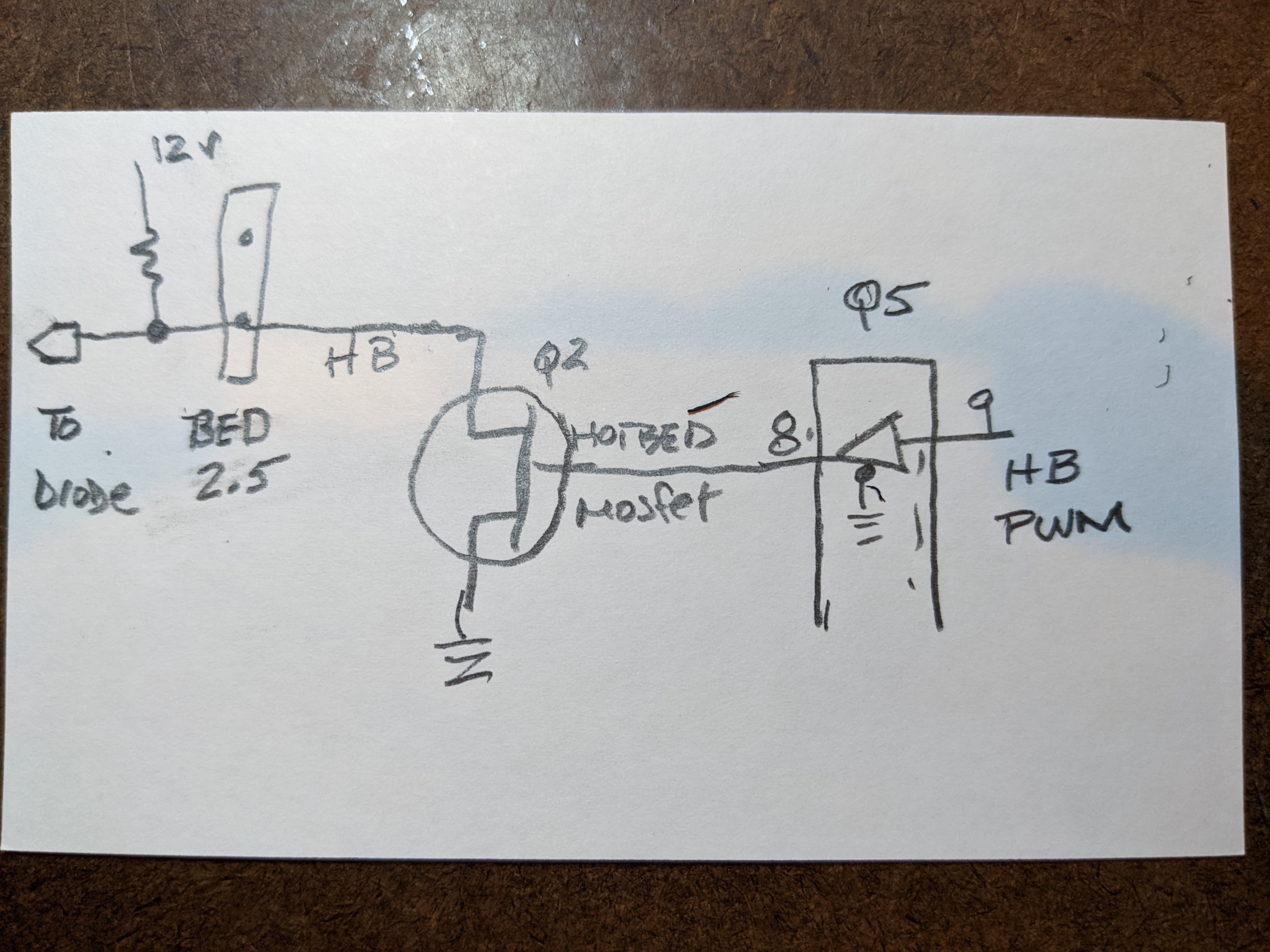

The Hotbed output (HB)connects to the drain of Q2. The gate of Q2 (HOTBED MOSFET) connects to pin 8 of U5. U5 is a noninverting buffer and the input to that buffer is pin 9 (HB PWM).
Therefore the output labeled HB (Bed 2.5) is a PWM capable connection and it requires no level shifting etc.
If your diode needs a voltage other than what you are powering your controller you will need a pullup to that voltage. Otherwise, you can connect a pullup to the controller’s voltage (VBB).
Depending on the laser you are driving and the running firmware you may need to invert the PWM signal which often can be done in the firmware settings.

And that is because you needed a pullup resistor which I thought Don mentioned. Think of it like this:
You have a toggle light switch on the wall and the light turns on when the switch is in the UP position but the switch will not stay UP, it falls back down( broken internal spring). So, you need something to keep it pulled UP just enough so it stays UP and stays DOWN. The HB/2.5 negative side is that pull DOWN so you would need to place a 4.7K resistor in the same negative terminal but hook the other side of the resistor to 5V(Yes, you can get the 5V from the servo header). Now, when your software is not commanding pin 2.5 to do anything, the resistor is pulling the Laser signal UP to 5V and when your software is commanding the laser to turn ON, it pulls pin 2.5 low(to ground) and your laser turns on.
