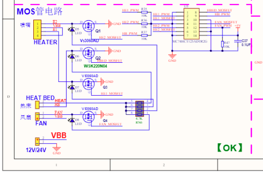

It depends on what your laser cutter power supply wants for PWM control. Some LPSs want to see the PWM signal pulling low( active Low ) and some what to see the PWM signal pulling high( active High ).
My K40 LPS likes active Low so I use the negative side of the HBed. Besides, isn’t the positive side of the HBed tied to your input voltage(12V or 24V) therefore it is not even controllable?

I would use one of the open-drain MOSFET drivers that support PWM.
Looks like you will need a pullup to 12V.
Schematic here: BIGTREETECH-SKR-V1.3/SKR-V1.3-SCH.pdf at master · bigtreetech/BIGTREETECH-SKR-V1.3 · GitHub

What do you mean by HB output? It would help me to understand if you would refer to the schematic.
I’m confused? The MOSFETs are open-drain so the output is not any particular voltage until you pull them up. You can pull up the output to whatever voltage your PWM voltage requires??
Heat Bed output

as was mentioned and if you look at the schematic the FET(transistor/switch) for the HeatBed is connecting Ground to the Neg side of the connector. The Positive side of the connector is wired directly to the boards input power( 12v or 24V ).
Think of it like this: You have a battery with Neg side and Pos side and you have a light(or heater element as in the heat bed) with 2 wires and it really doesn’t matter which wire since the light and the heater will heat no matter which way it is connected. Now you connect one wire to the Pos side of the battery. YOU will be like the FET/transistor/switch when you take the other wire from the light/heater and touch it on/off to the Negative side of the battery. For PWM you hold it on for 5 seconds then off for 5 seconds, on for 5, off for 5. you just did 50% duty cycle PWM.
This is how those things work on your board. The negative side is getting connected and disconnected to Ground which is the negative side of your input power supply.

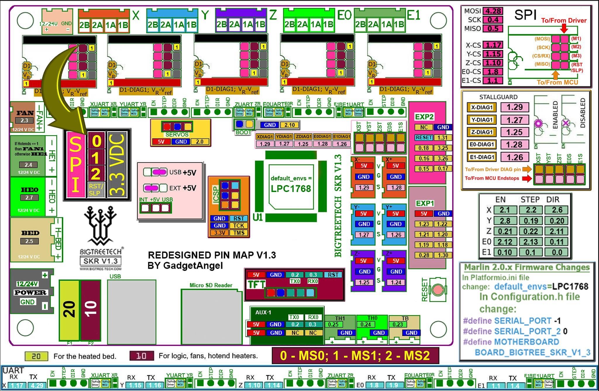

Yes, hardware pwm pin is connected to the MC74HCT125ADTR2G marked U5 in skr 1.3 board, but I have not found a direct pin header for HB-PWM 2.5 pin 68 in LPC1768 P2.5/PWM1.6/DTR1/TRACEDATA0
I guess that I could use the 2.0 pin, is direct from servo header. In LPC1768 is P2.0/PWM1.1/TXD1

And the pwm pin of the laser connected in servo pin 2.0, works perfect.
