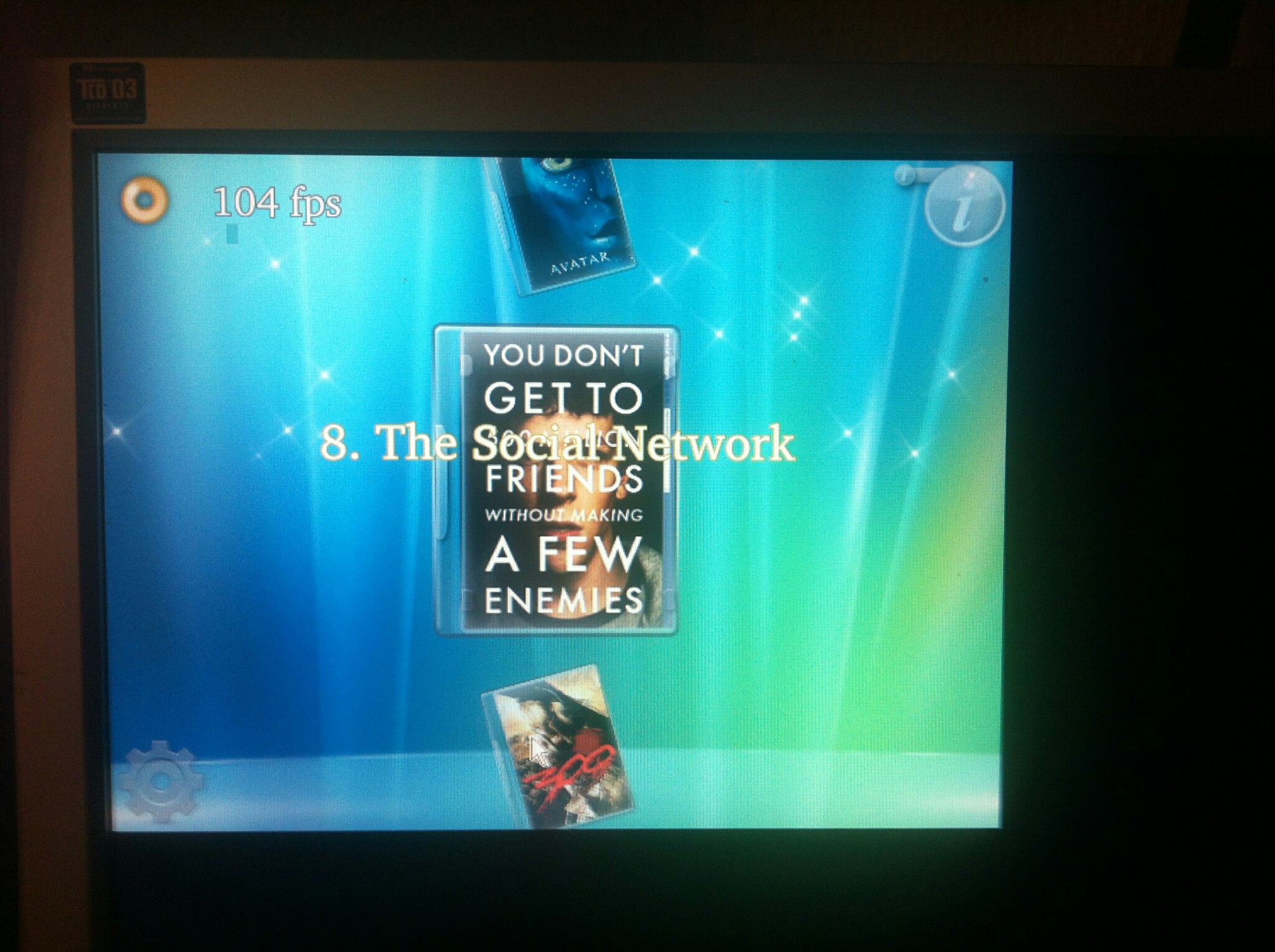

Qt5 Cinematic Experience on BeagleBone Black (OpenGL ES/QtQuick2) benchmark 640x480 & 1280x1024
@Walter_Myzhar_Lucett this program has been used quite often on other embedded boards to check the qt graphic performance (http://youtu.be/TzNWqoJRFsc).
My impression is that modern and gui rich programs can be well run on the beaglebone black with resolutions up to 1024x768. When using higher resolutions like 1280x1024 the performance drops quickly.
I’ve used a self compiled and patched 3.12 kernel (ubuntu rootfs). Unfortunately the cpufreq interface changed in recent kernel versions. I didn’t find the time to verify whether the processor was running at the speed of 1GHz. The graphic output was directly rendered to the framebuffer, without a flip chain.

Patched 3.12 kernel, 5.00.00 alpha release of the TI graphics SDK. Cross compiled qt5.1, rendering platform eglfs, no X.
Haven’t checked the newly released 5.1 gfx sdk yet, nor the compatibility with the “official” 3.13 kernel.
