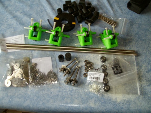

QuadRap start is getting closer …
only waitin for a few parts like profiles and
ball bearings from China!

Stainless steel tubes from ebay.
180 gr/500mm 12/9mm
Nylon bolt?
@Mauro_Manco
As i said, i try it.I’m not afraid.
Weight only 85gr so far for one mover.
Tubes 180 gr each.

Be careful with the tubes, the measurement seems not to be o.k.! The chinese linear bearings sliding very hard!
Maybe sanded with sandpaper !?!
Not useable for linear-bearings!
Have to switch back to igus!

Ordered AWMR-12x500.
Carriage with polyamid-screws seems to work well.Only tested by hand!
