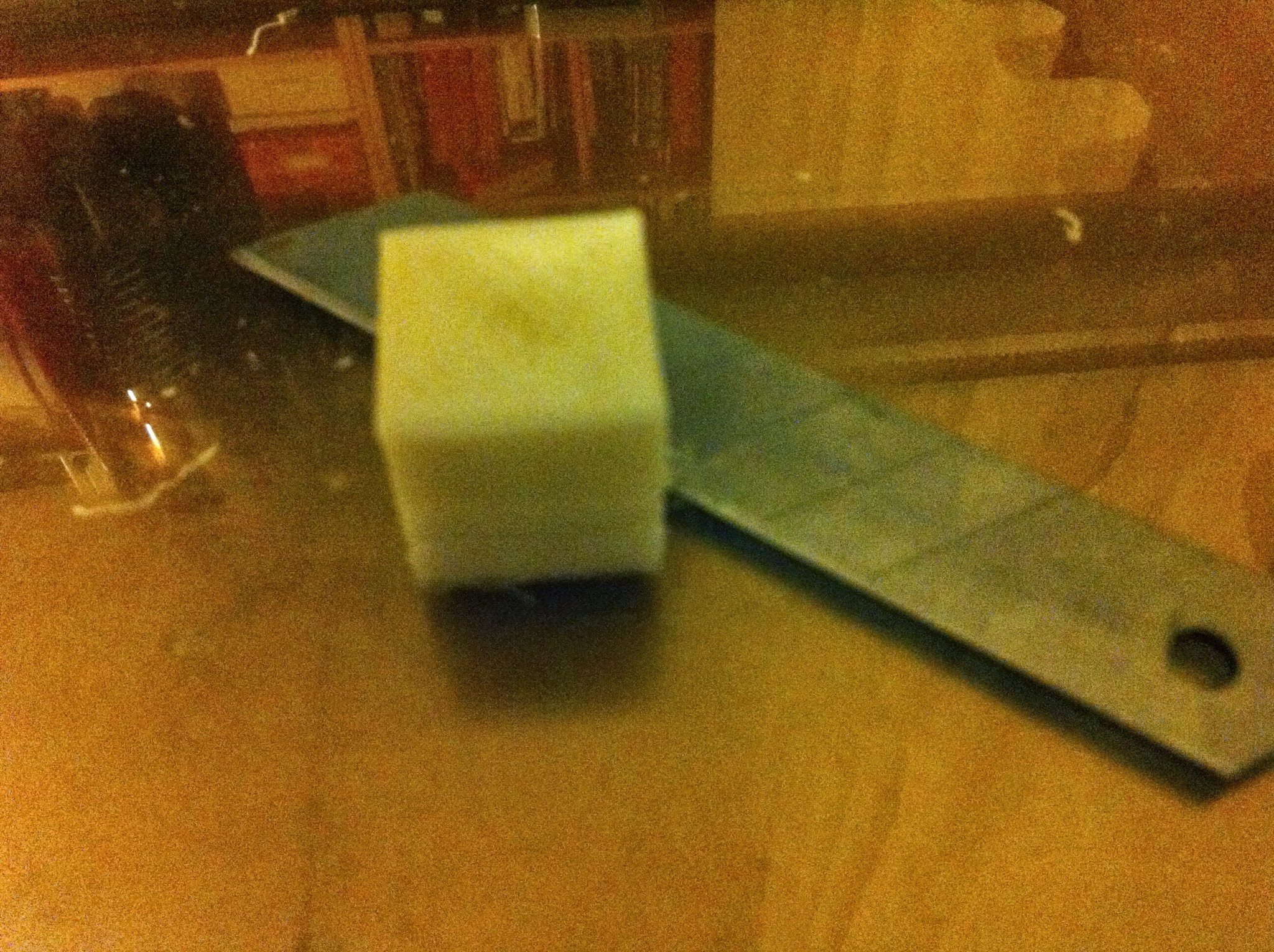

QuadrapCoreXY first print, cube 20x20x20mm
3mm ABS@80mm/s, 0,4mm nozzle, 0.4mm layers. I changed the temprature during the print, the last bit that looks best was printed @260°C, printed on cold 1/8" PEI sheet
